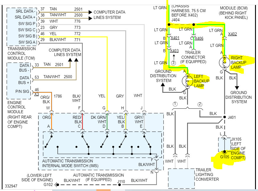

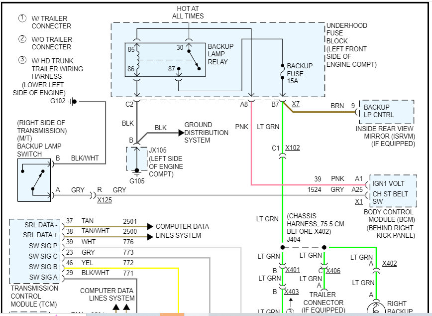

wire color to backup light switch.
Sep 25, 2022 at 4:20 PM
I attached the wiring schematic below for the entire circuit. The power supply to the lights is light green.
Take a look through it and let me know if you have other questions. Also, I had to cut the schematic in half to make it readable for you. I did overlap the two so you can follow from one to the next.
See pics below.
