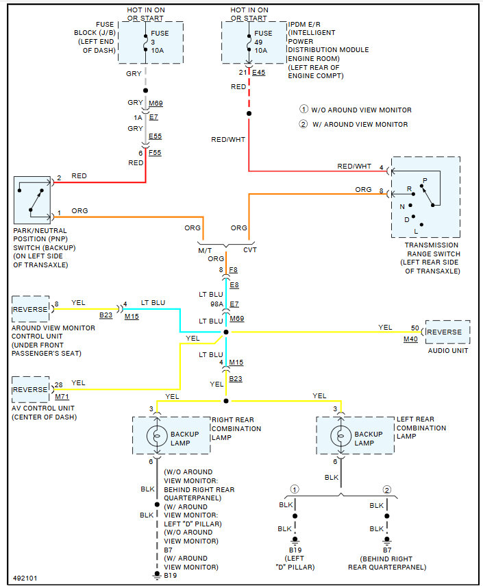

I need the wiring diagram for the reverse light circuit so I can properly wire in a backup camera.

Sure, here is the reverse light wiring diagram. Check out the images (below). Let us know if you need anything else.
