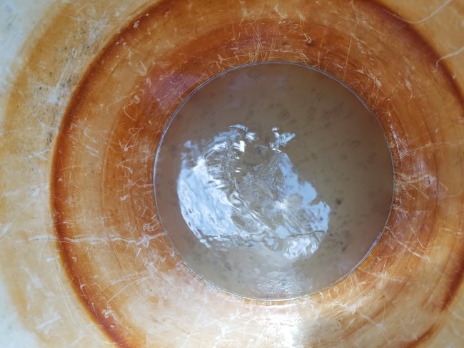

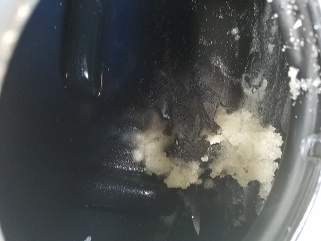

Here is something we would NEVER have guessed we found a white Sand/salt/sugar in the tank see pictures there was alot of it not sure what is actually was but my husband said it tasted sweet yes he tasted it curiosity I guess we had to get another fuel pump because the pressure was below 50 I will update when the van is back together
May 28, 2017 at 12:48 PM
O man, good find on that one. Please let us know when you have it back together.
