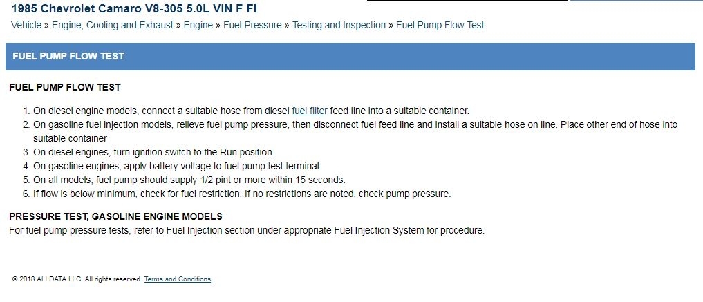

I am not that familiar with the workings of an edelbrock carb to which if they have separate jets fro the front or rear but I was just asking about the fuel system cause it seems to me as though that is where the problem lies simply because of the fact that the problem isn't there at idle or just off idle but rather when at high rpm.
