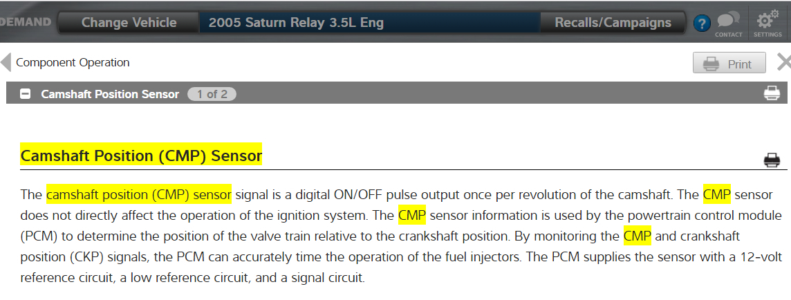

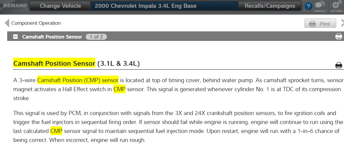

It looks like the two different engines use two different types of strategies for their Camshaft Position Sensors (CMP)(s). The answer here is to run the original 3.4L CMPs to make not only the wiring harness, but more importantly the Power-train Control Module (PCM) which is going to use the information any ways, to work effectively in providing Electronic Fuel Injection (EFI) control. I have included the descriptions of the two different CMP operating systems in the diagrams down below for comparison.
Get back to us with how it turns out or if you have additional questions, please, don't hesitate to ask. That's what we are here for.
