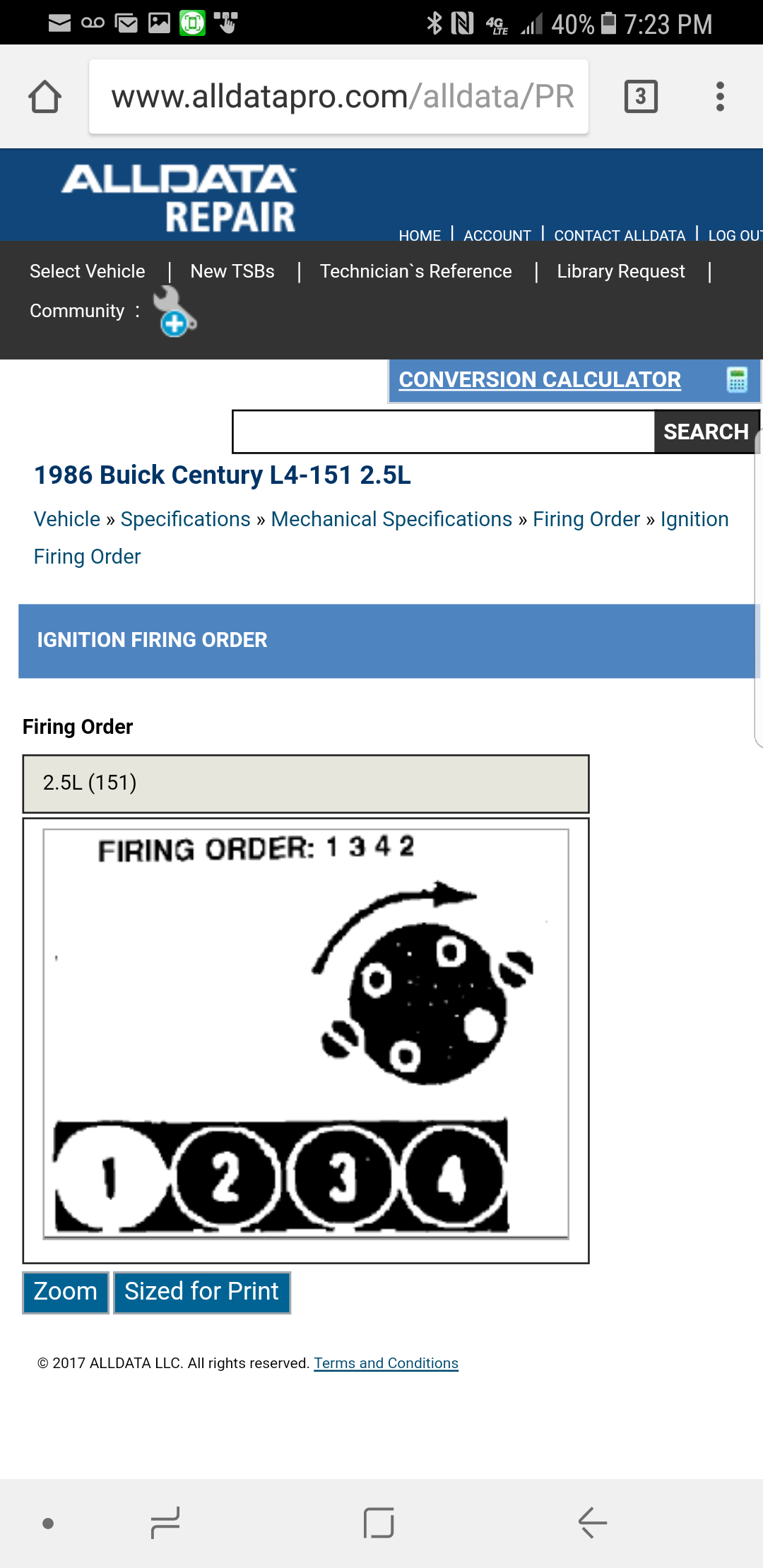

I posted the firing order and spark plug routing on the distributor cap.
Oct 23, 2017 at 7:25 PM
CRAZY CRACKER
  • 10 POSTS
So number one wire goes to the cap point front closest to drivers side and number three goes front side closest to passenger side.
Oct 23, 2017 at 7:33 PM
SATURNTECH9
  • 30,869 POSTS
Yeah one, three, four, two, is that what you have?
Oct 23, 2017 at 8:00 PM
CRAZY CRACKER
  • 10 POSTS
I think that is the way i have it, but it is after ten at night so i will have to double check tomorrow after work around 6:00 pm and then relay my findings to you. Thanks for all your help, tolerance and patience to a shade-tree guy.
