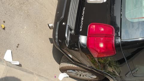

Thank you for your kind respond, I already did most of what is in you link. Attached video for your kind reference.

Okay, after listening to the video, we need to check fuel pressure. It sounds like it may be low or the pump has failed. Here is a link that explains in general how to check pressure:
Here are the manufacturer's specifications:
2005 Lincoln Truck Navigator 4WD V8-5.4L SOHC VIN 5
Pressure, Vacuum and Temperature
Vehicle Powertrain Management Fuel Delivery and Air Induction Fuel Pump Fuel Pressure Specifications Pressure, Vacuum and Temperature
PRESSURE, VACUUM AND TEMPERATURE
ITEM .................... SPECIFICATION
Fuel Pressure
Key on, engine off .................... 240-310 kPa (35-45 psi)
Engine running .................... 193-310 kPa (28-45 psi)
___________________________
Let me know what you find.
