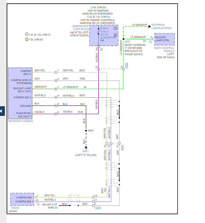

This happens when the camera goes out and needs to be replaced or the fuses are blown, here are the wiring diagrams so you can see how the system works and which fuses to check with how to change out the camera in the images below in case you need it. Check out the images (below). Let us know what happens and please upload pictures or videos of the problem.
