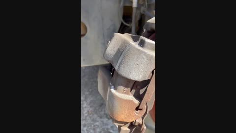

here's what it looks like:

Okay, from the video it looks like the pads could be worn out and letting the caliper slide out too far. If you look into the slot at the rotor and the pads themselves how much friction material is left on the inner pad? Hard to see from the angle but it looks like the piston is extended pretty far. I would also look in the rim and see what is actually rubbing, I have seen wheel weights that are stuck on that started to fail, but usually those just get torn off.
Thank you for the video, if you have a chance, you could shoot a few pictures straight onto the caliper so I can see the rotor and pads.
