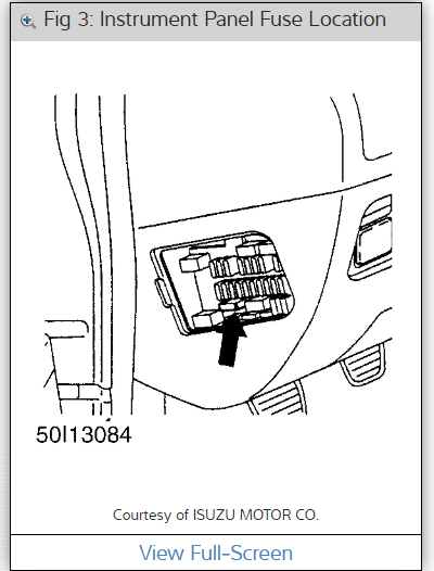

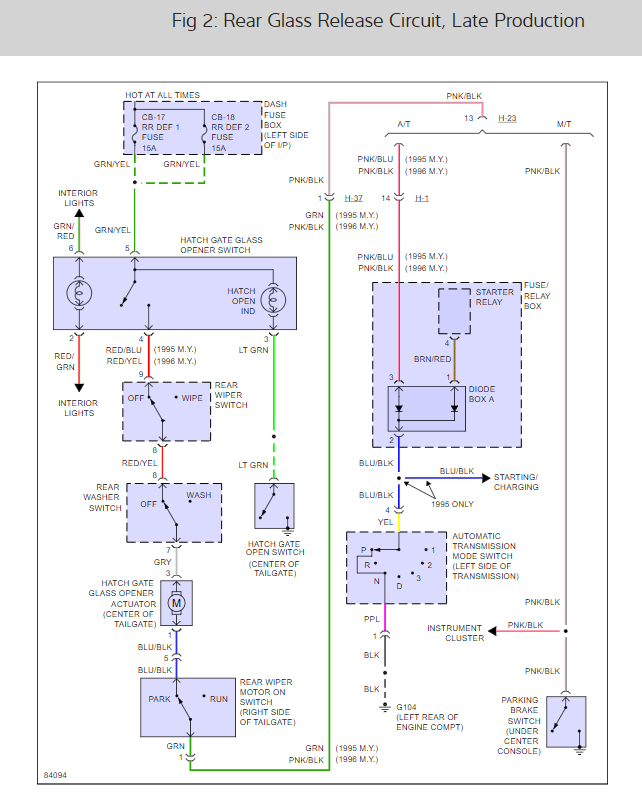

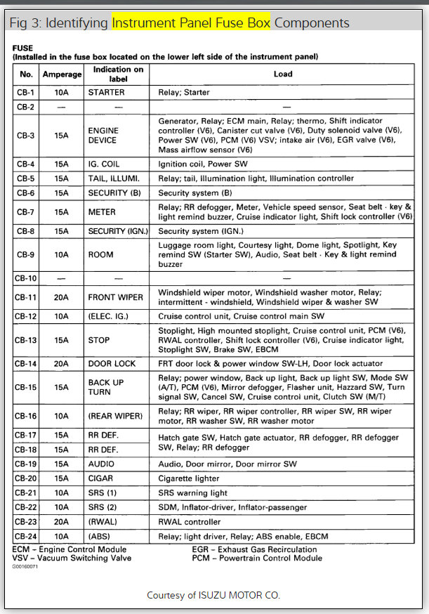

Lets check the fuse (CB-17 and CB-18). Here is the wiring diagrams so you can see how the system works and a guide to help check the fuses along with the fuse location:
