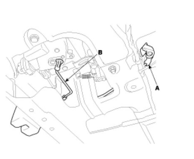

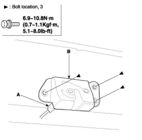

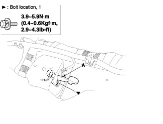

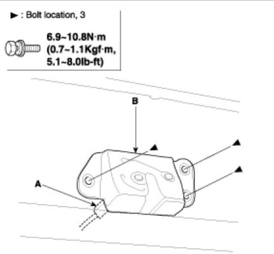

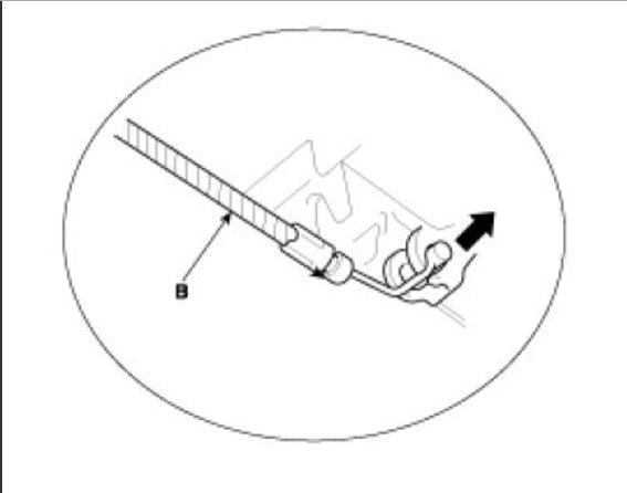

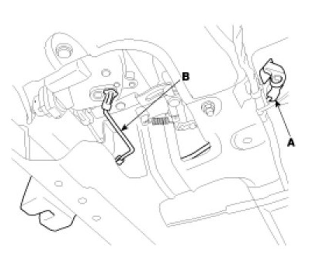

Here are some diagrams (below) for your car.

You will need to remove the inner panel becasue it sounds like the cable has come off of the latch, Here are some diagrams so you can get the problem fixed.
