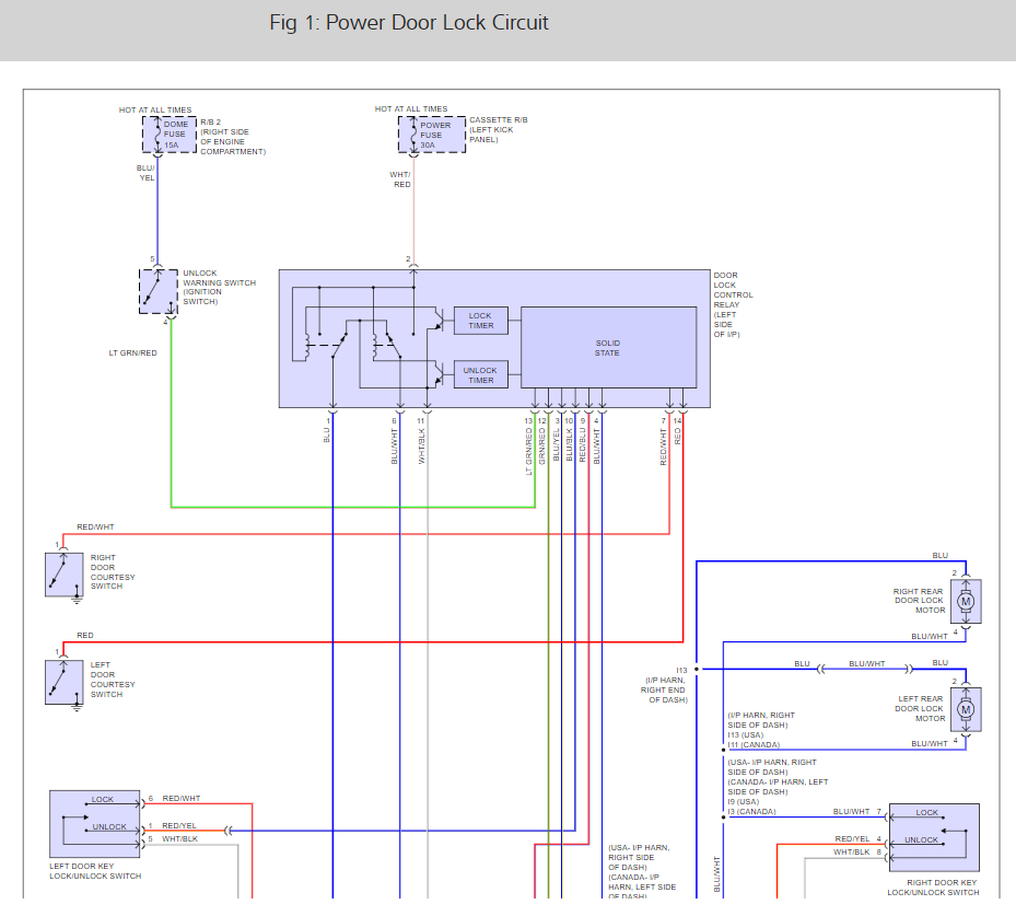

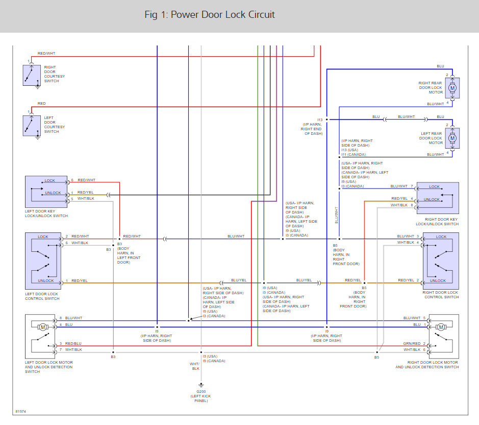

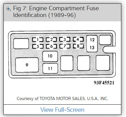

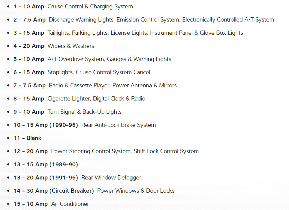

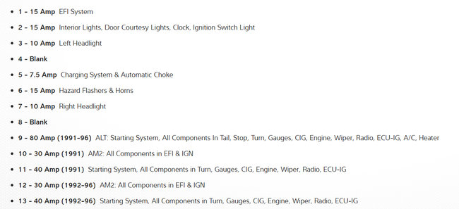

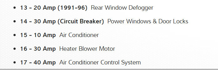

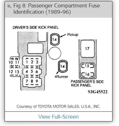

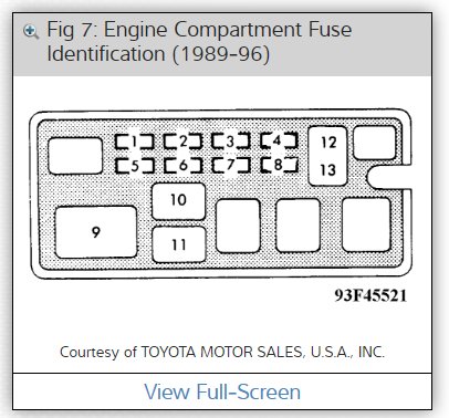

Yes, it sounds like it. Lets check the fuses first.
If the fuses are okay lets test the wiring and power. You will need to remove the inner door panel to work on the latch to get it to open this can be a little cumbersome but hang in there you will get it.
Check out the diagrams (below). Please run some tests and get back to us.
