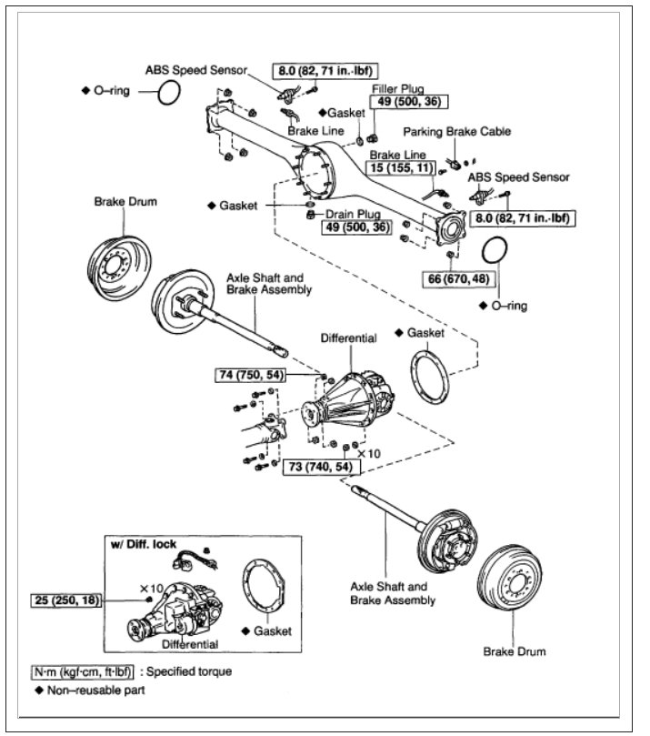

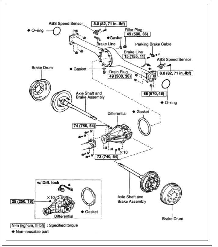

It sounds like you hit it on the money, the LSD must have special lubricant if not the car will vibrate at low speeds in turns. Here is a guide to help you see what you are in for when servicing the differential:
https://www.2carpros.com/articles/differential-service
Differential
Type Hypoid gear oil
Grade API GL-5
Viscosity:
Above 0°F (-18°C) SAE 90
Below 0°F (-18°C) SAE 80W or 80W-90
Here is how it will be on your car you can see the drain and fill plug in the diagram (below) Please let us know what happens.
