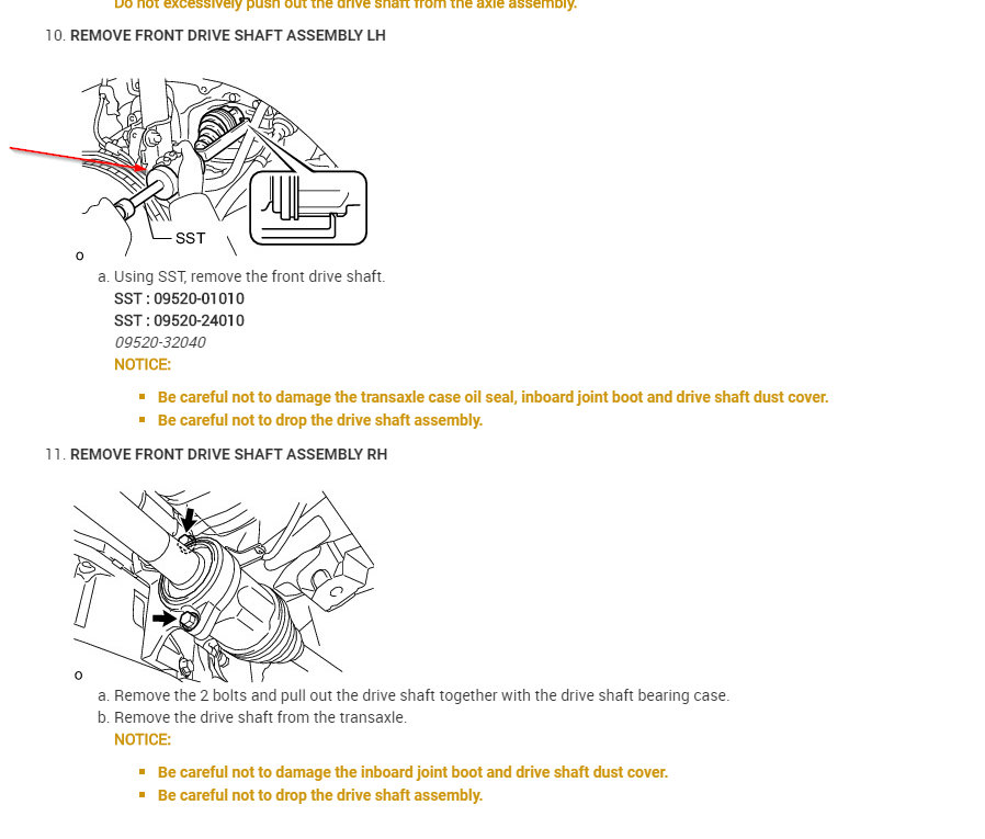

REMOVE FRONT DRIVE SHAFT ASSEMBLY LH
Pic 3
Using SST, remove the front drive shaft.
SST : 09520-01010
SST : 09520-24010
09520-32040
NOTICE:
Be careful not to damage the transaxle case oil seal, inboard joint boot and drive shaft dust cover.
Be careful not to drop the drive shaft assembly.
REMOVE FRONT DRIVE SHAFT ASSEMBLY RH
pic 4
Remove the 2 bolts and pull out the drive shaft together with the drive shaft bearing case.
Remove the drive shaft from the transaxle.
NOTICE:
Be careful not to damage the inboard joint boot and drive shaft dust cover.

Yeah. These are pretty tough to get out and you most likely are going to need to use a slide hammer. I attached the info from the manual and it shows using a slide hammer.
Basically this is something that hooks on the back of the axle and then you use the slide hammer portion to use the force and shock of the sliding hammer to break it loose.
Take a look at this and let me know what questions you have. You can rent these at most parts stores so you don't need to buy them.
