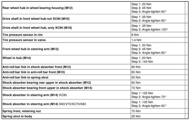

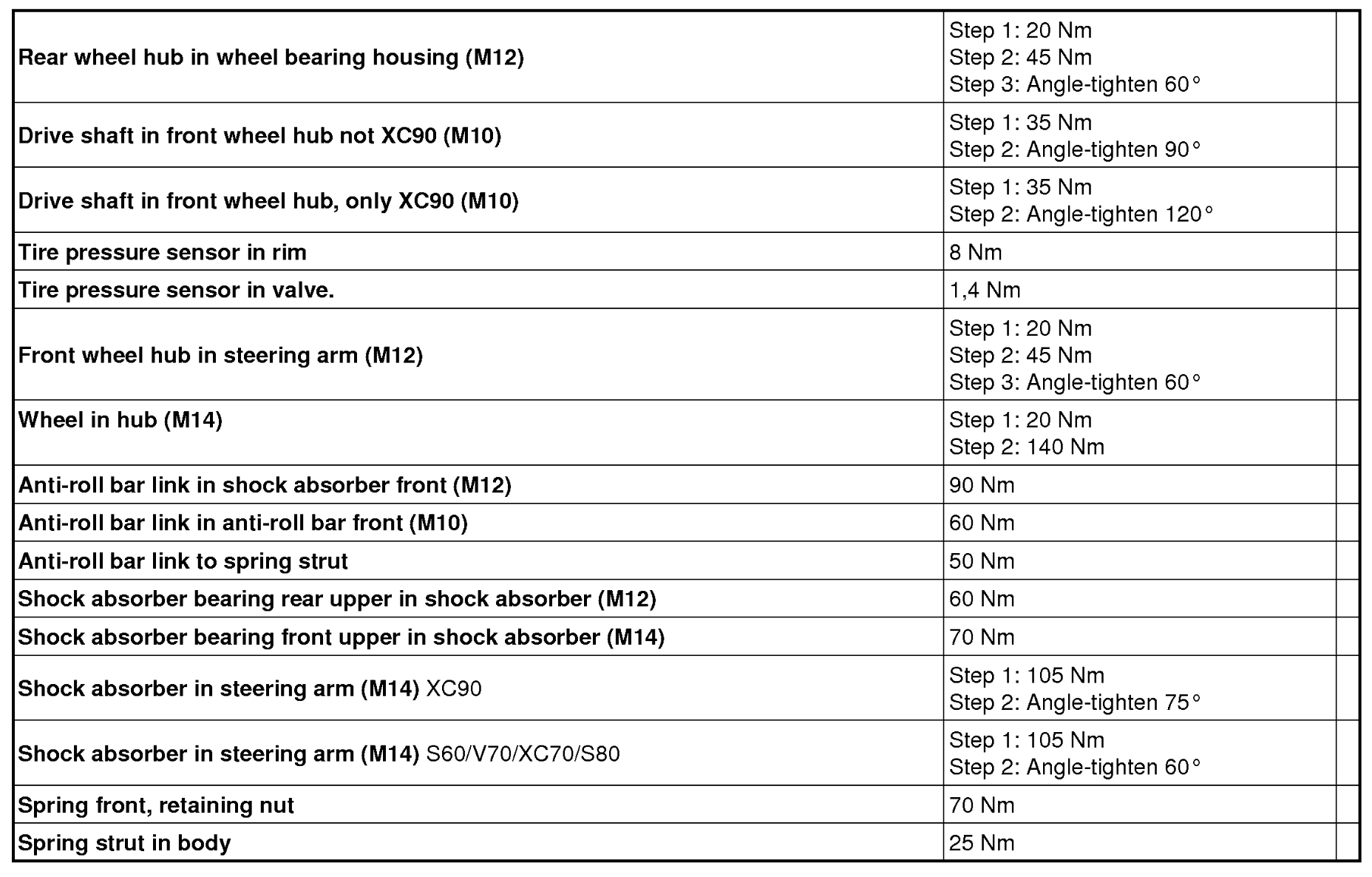

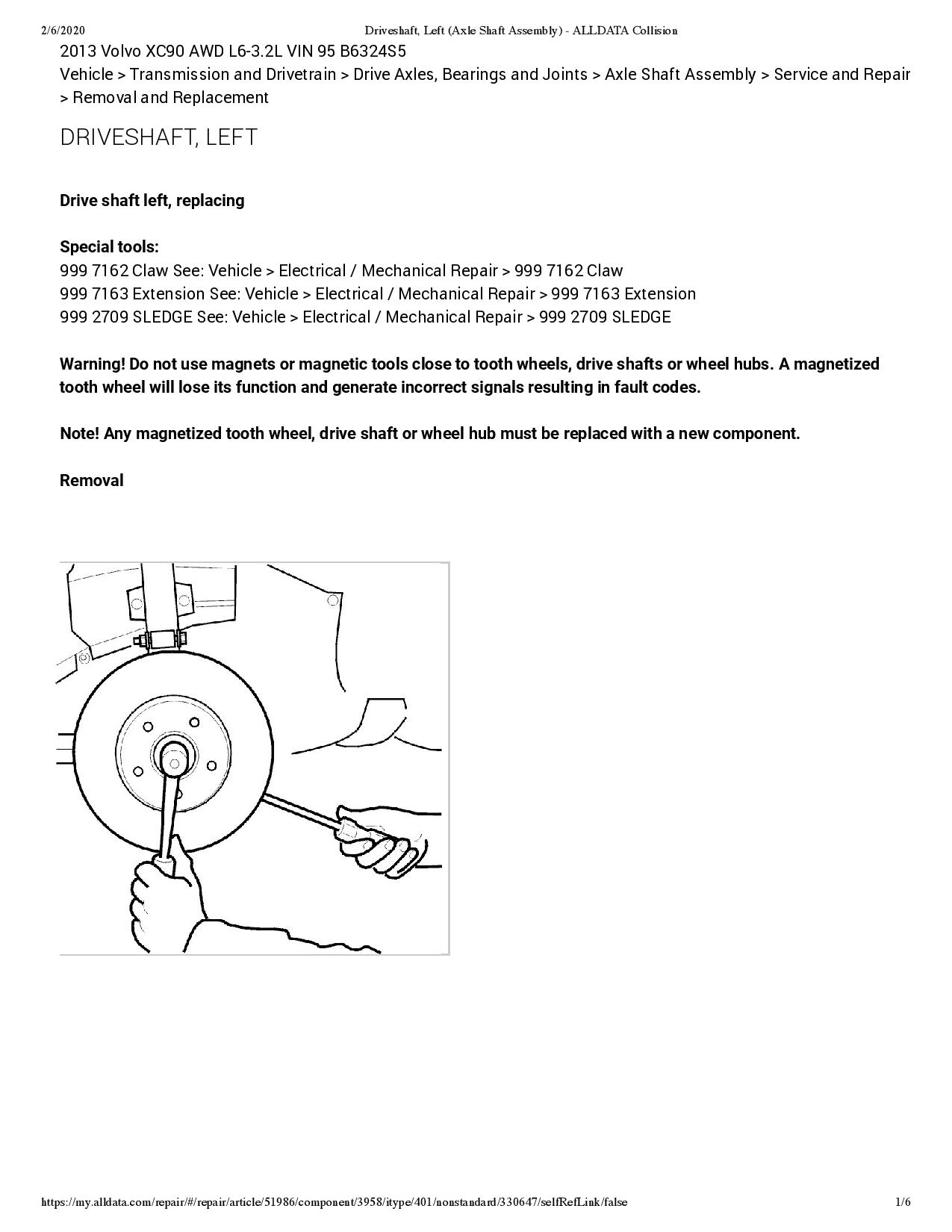

The spec i have here is for an m10 bolt for XC90 vehicles.
Check the threads on your axle bolt are 10mm in diameter.
It calls for 35NM followed by a further 120 degrees.
You will need a torque angle gauge to torque this correctly or a torque wrench with the angle function.
You should replace the bolt with a new bolt as all angle tightened bolts have to be replaced they cannot be reused.
Regards, Joe
