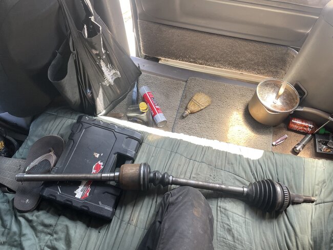

If you're still having trouble, try to post a photo of the inner and outer CV joints, then I'll see if there is something I overlooked.
