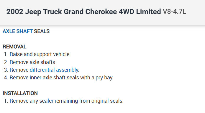

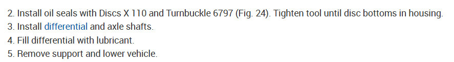

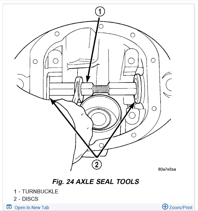

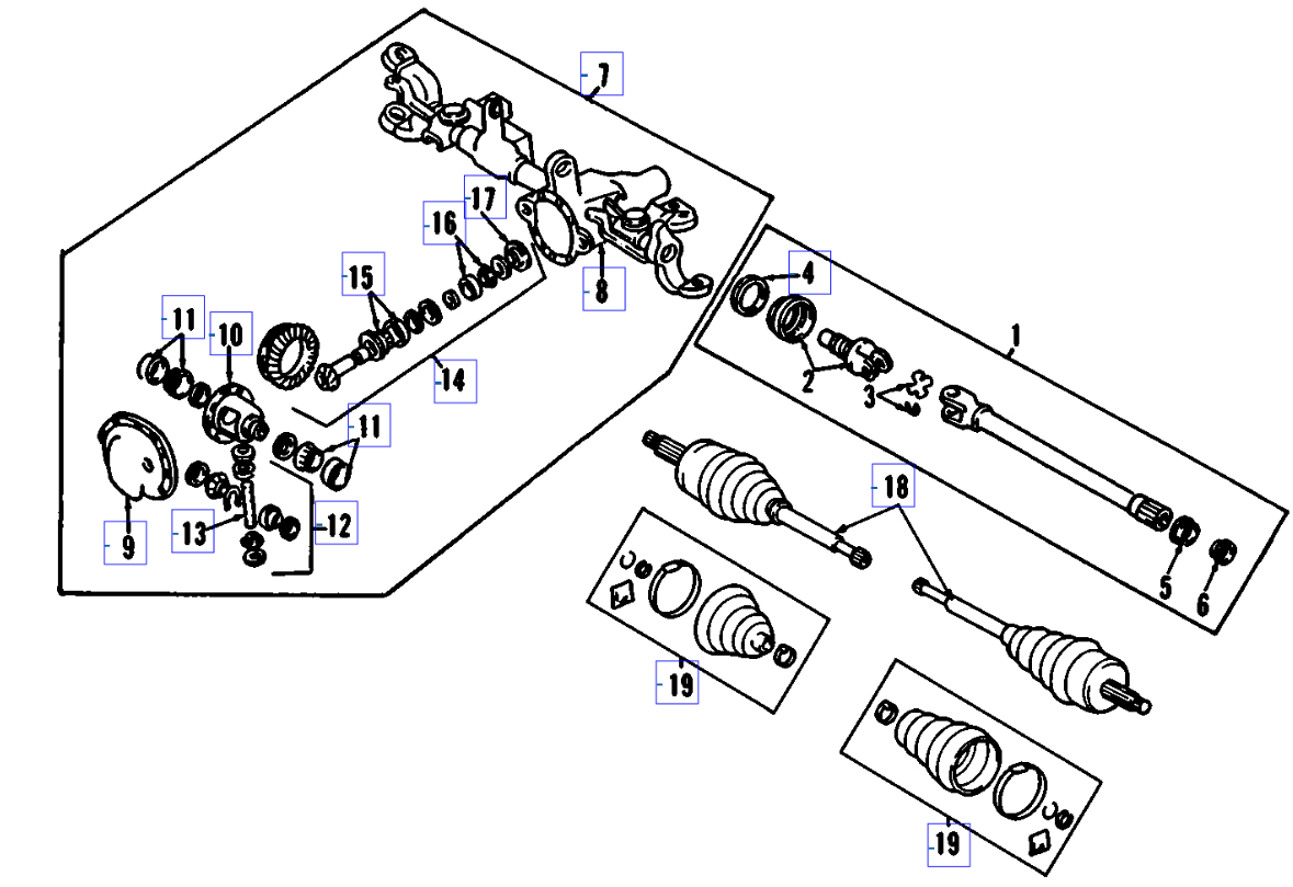

Okay, this is a job, the front differential needs to be removed and disassembled. The axle seals are internal and are one of the last parts to be removed when the differential is taken apart. Check out the images (below). Please let us know what happens.
