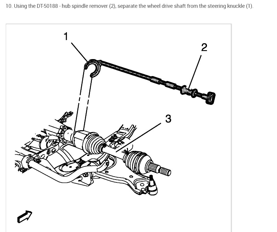

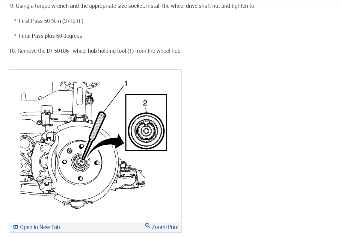

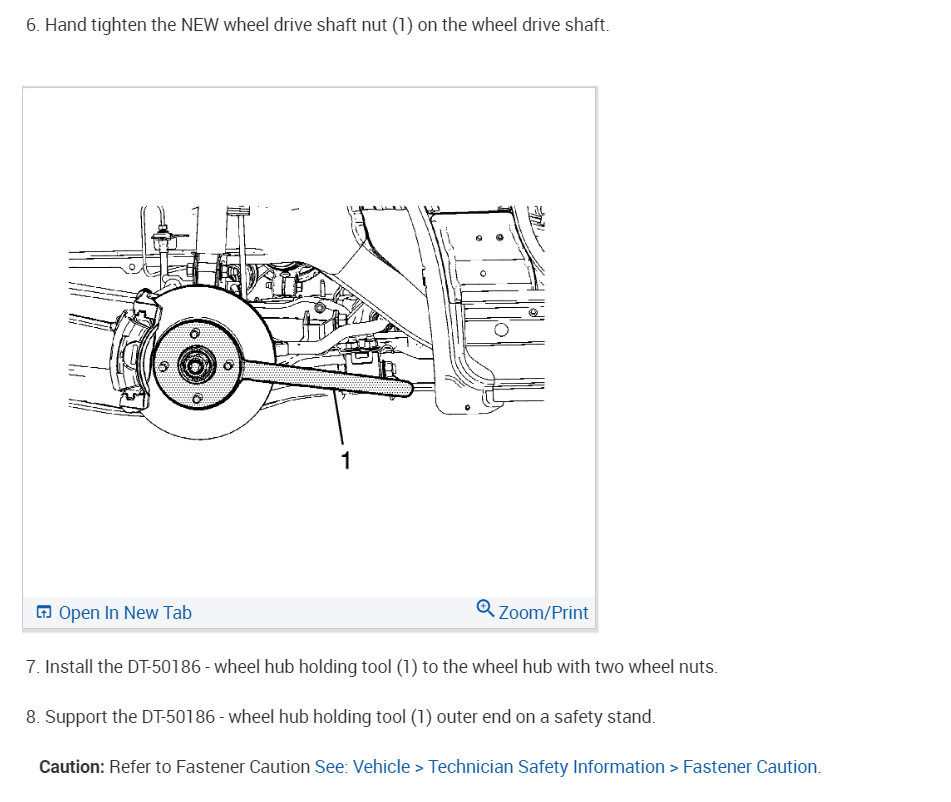

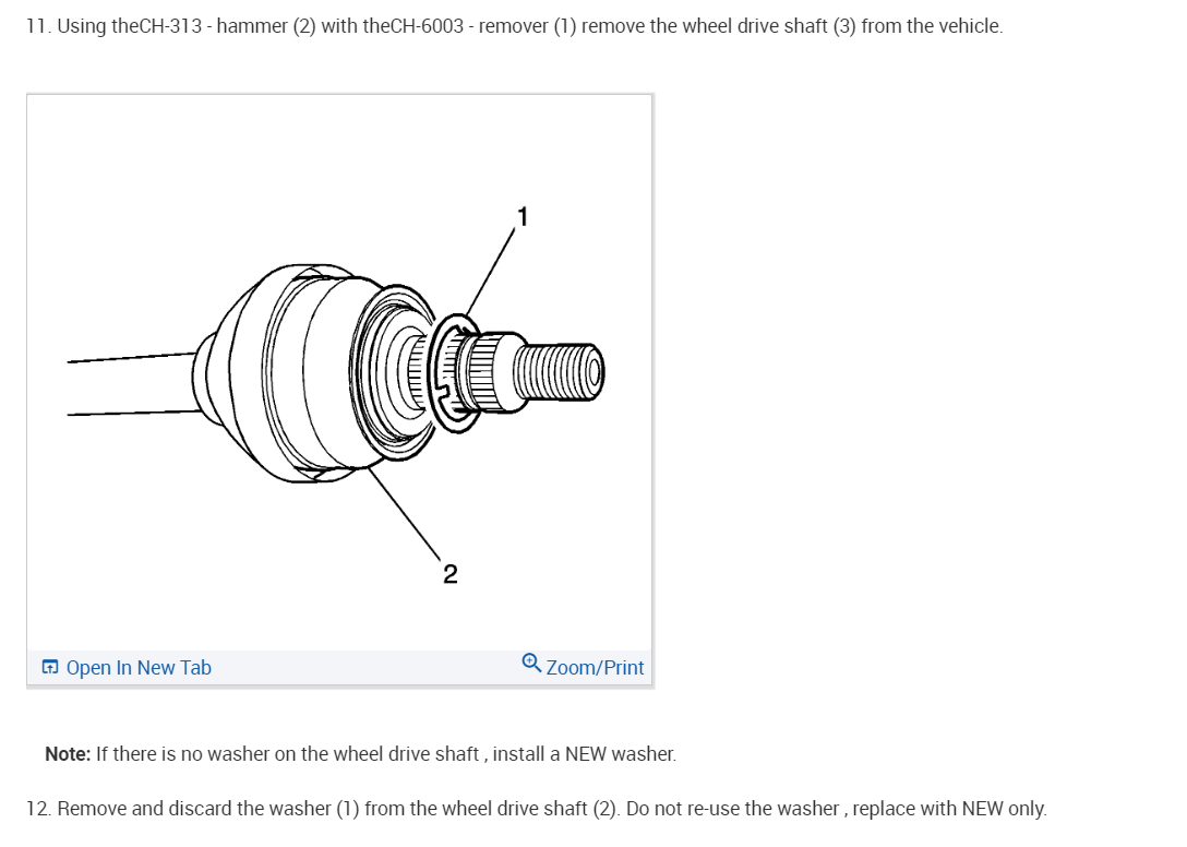

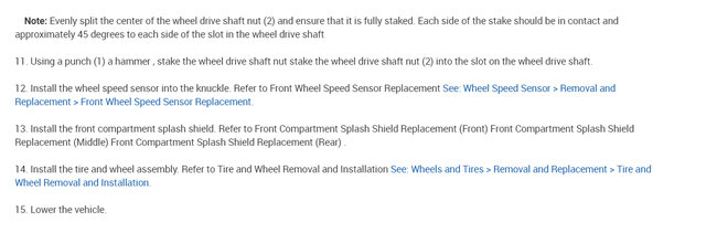

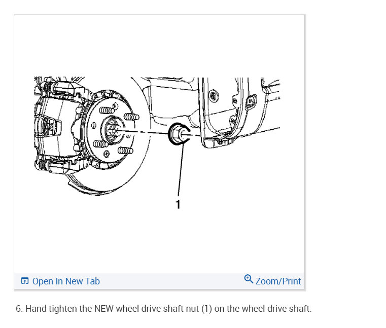

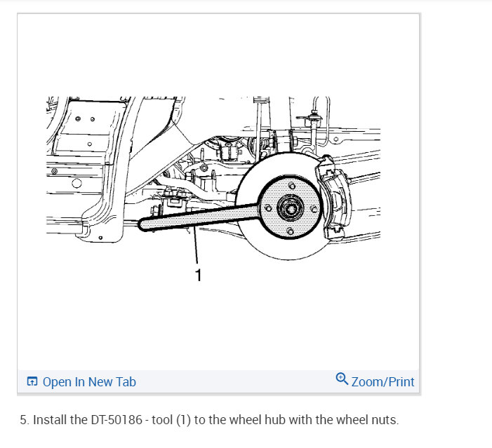

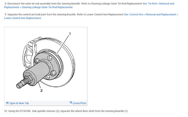

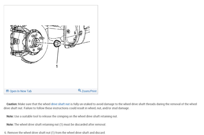

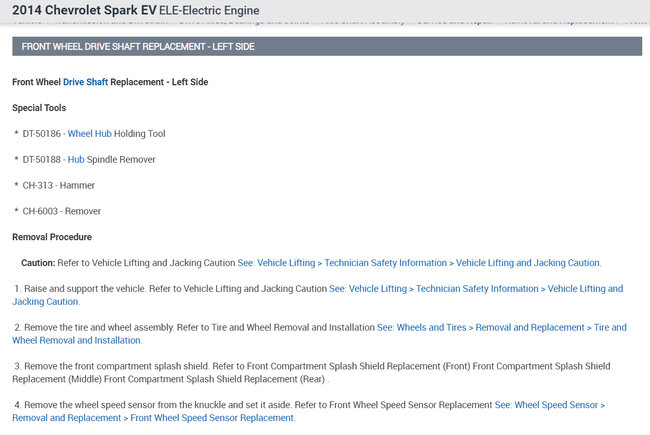

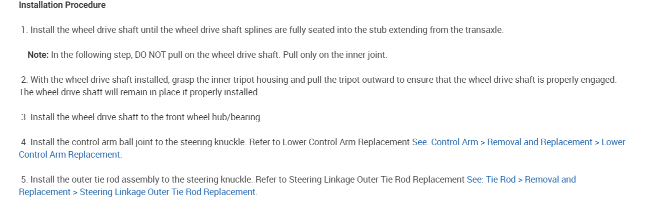

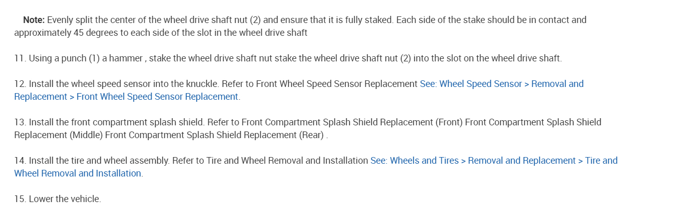

Can you give me procedure for axle nut replacement and axle?
Mar 17, 2023 at 7:08 AM

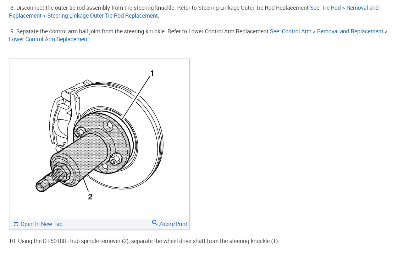

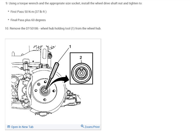

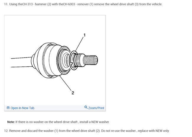

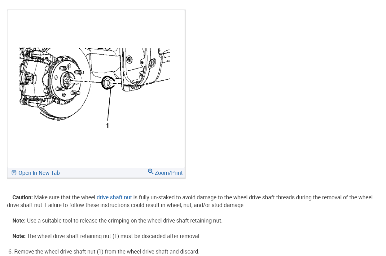

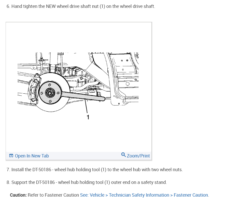

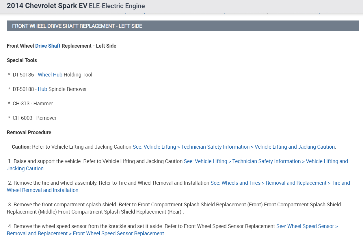

Sure, we are giving you the instructions on how to change the axle nut and CV axle shaft in case you need it. The axle removal tool you can substitute a large pry bar instead. Also, you can loosen and tighten the main axle nut while the front tire is on and just barely touching the ground to help hold it from spinning. So, there are some workarounds possible. Check out the images (below). Please let us know if you need anything else to get the problem fixed.
