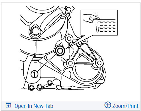

I would wait until the engine is cold, then open the cooling system to make sure it is full of coolant. Also, I would check the fluid inside the transfer case, if it is low the unit will overheat. I would change out the fluid because when it wears out it will slip and cause this code, there is a drain plug in the bottom of the unit.
Only use:
Type: Genuine NISSAN Matic J ATF --- 2-1/8 pt (1.0L)
Check out the images (below). Please upload pictures or videos in your response.
