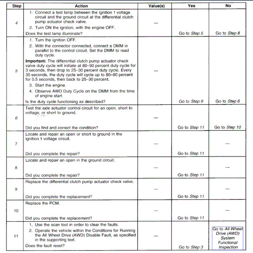

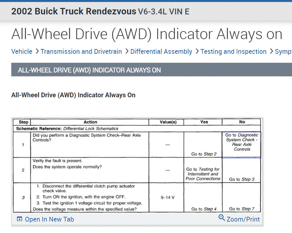

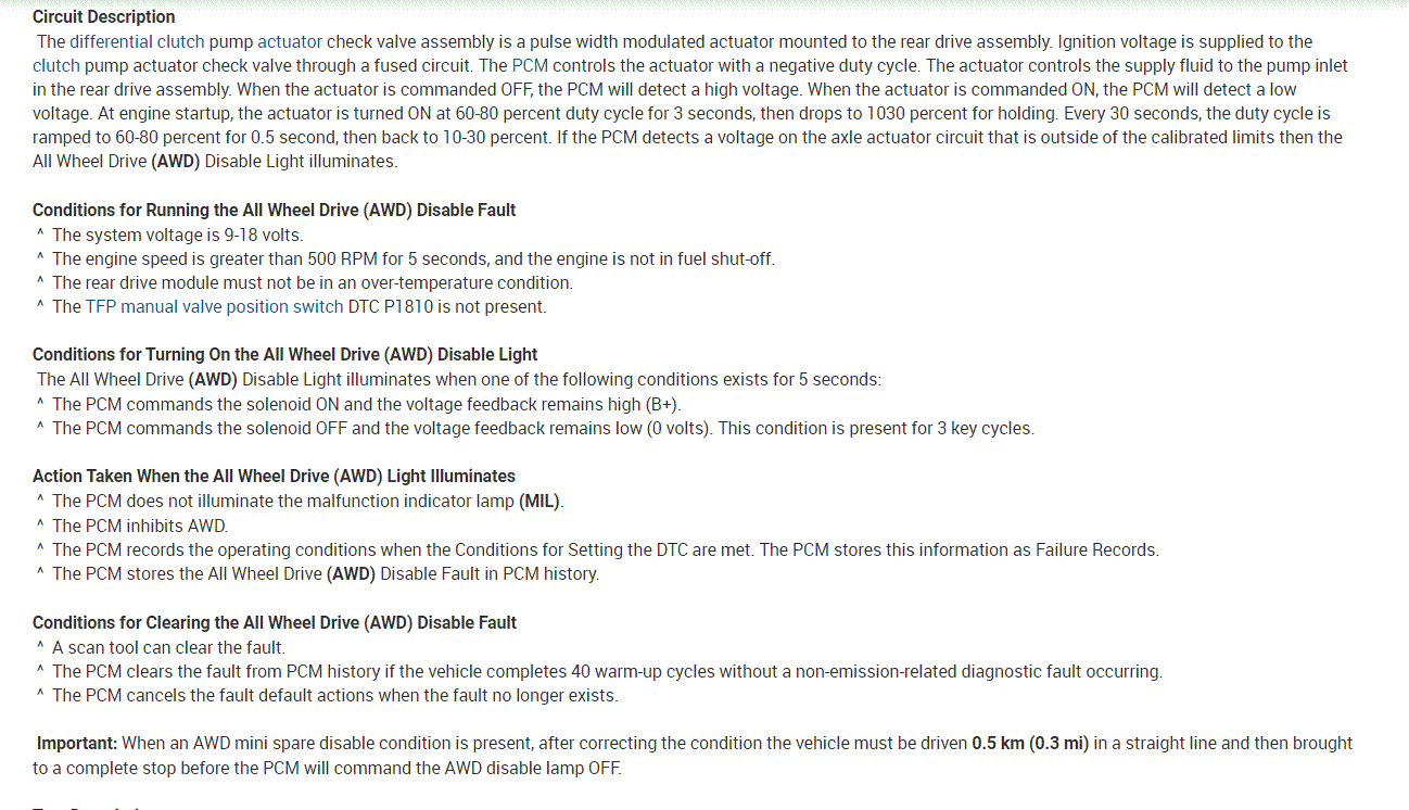

AWD light is on, had a bad front axle bearing, changed that, checked fuse 30-okay. bad springs and shocks in the rear, changed those. I don't know if that sensor in the differential could be the issue. i ordered a new one but not here yet, any advice if this sensor doesn't work?
