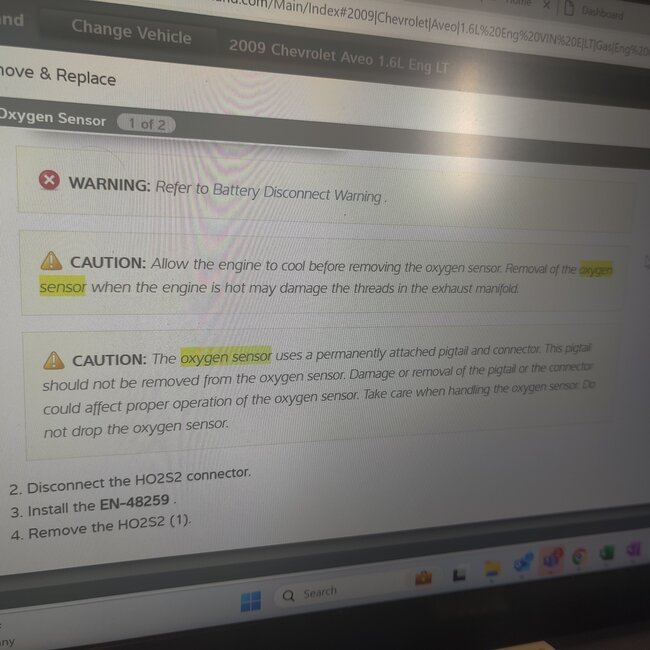

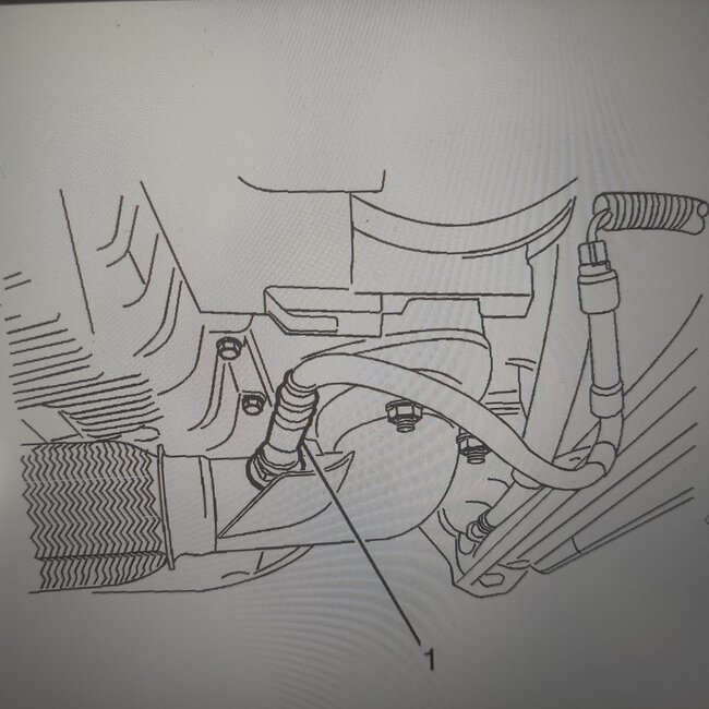

We took our car to the mechanic for an OBD scan, due to a Check Engine Light. The result was three codes:
P0137 - HO2S Circuit Low Voltage Sensor 2
P0446 - EVAP Vent System Performance
P2270 - HO2S Signal Stuck Lean Sensor 2
We need to get these cleared to pass inspection.
Any idea how to proceed without spending tons of money?
