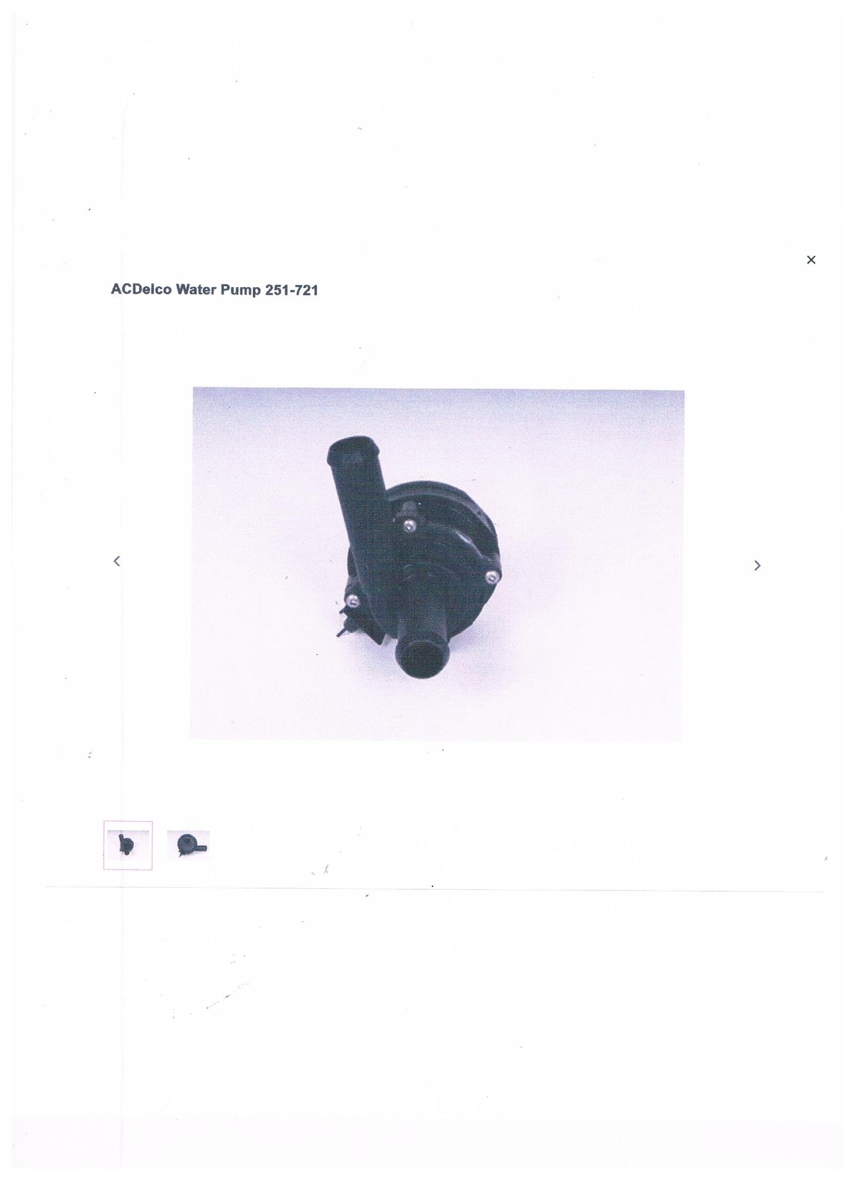

I have exhausted all possible search for this pump, but no results. I need your HELP in locating one. I know you are not a parts staff but hope you may give me some idea where to find this pump.
AC Delco number 251-721. GM part number 25808860.
Thanks for all you can do to assist.

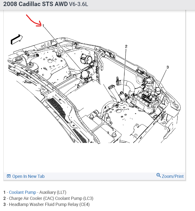

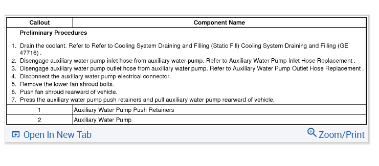

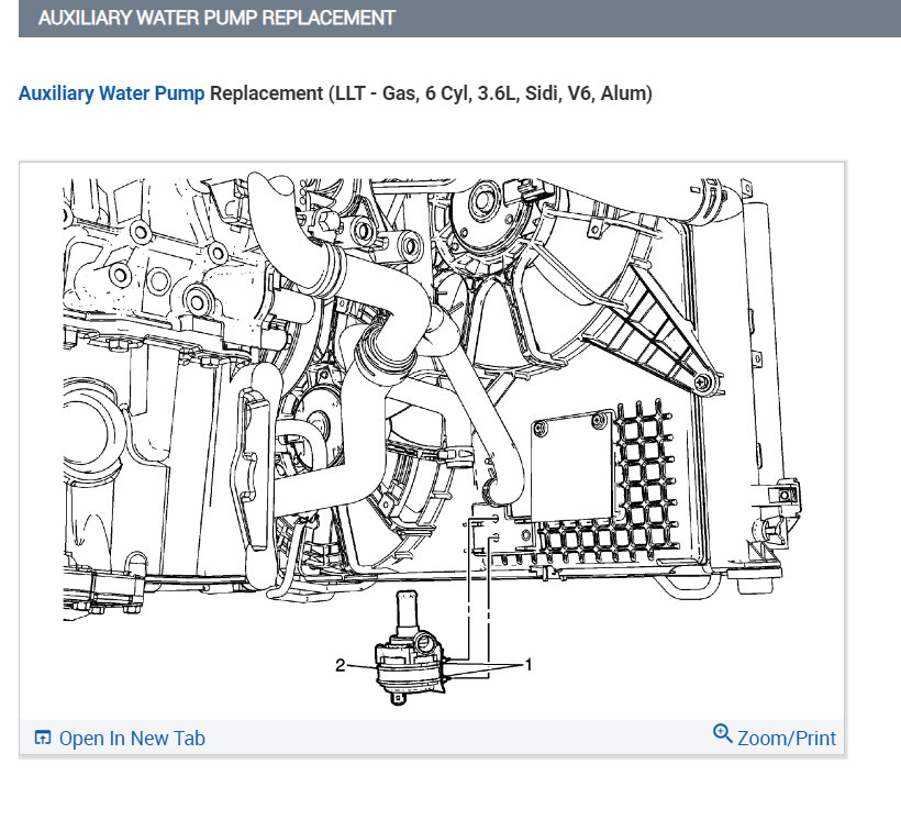

Sure, the auxiliary water pump is located on the left front of the engine compartment. Check out the images (Below). Please let us know if you need anything else to get the problem fixed.

I'm trying to find a physical pump. Not the location in the engine. Sorry for the misunderstanding.

Did you look at the images I posted above? It shows the auxiliary water pump location.
