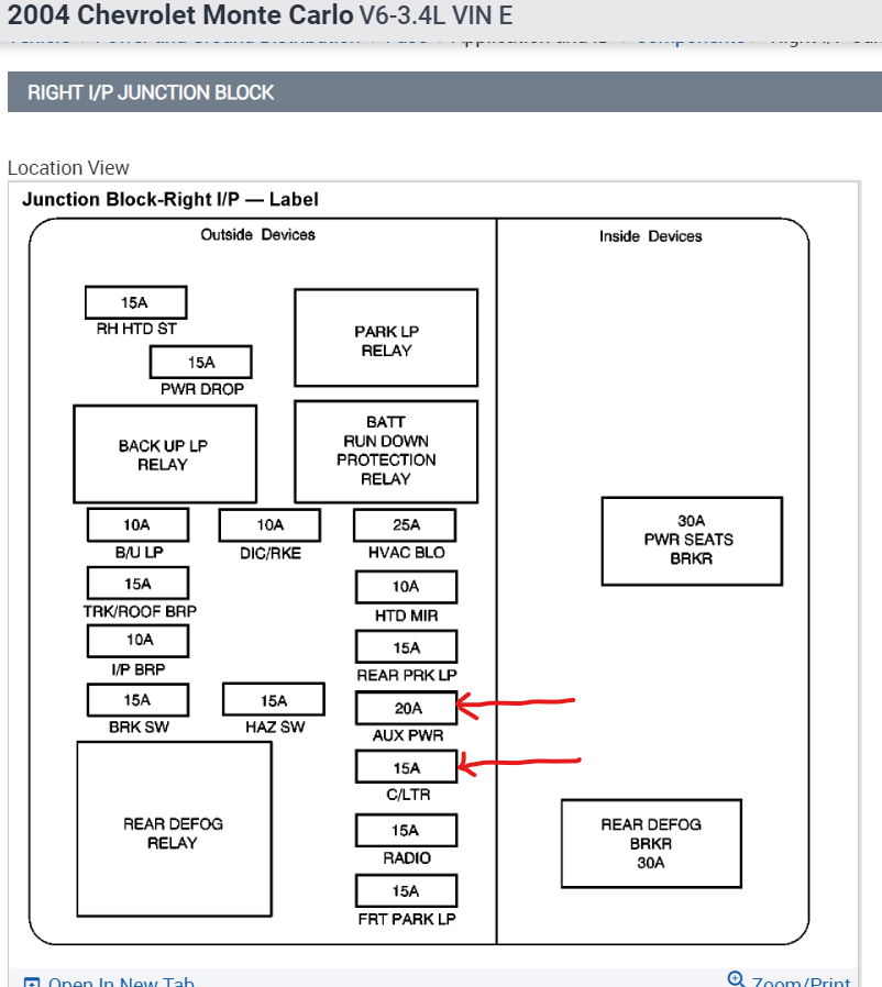

The auxiliary outlet in front not working?
2004 CHEVROLET MONTE CARLO
135,500 MILES
FRANKIMAN
Nov 3, 2023 at 10:21 AM
Please check the fuse C/LTR and AUX fuses in the fuse panel on the right side of the dash (access panel). This guide can help and check the images below:
Check out the images (below). Please let us know how it goes.
