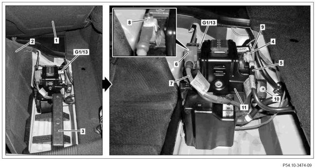

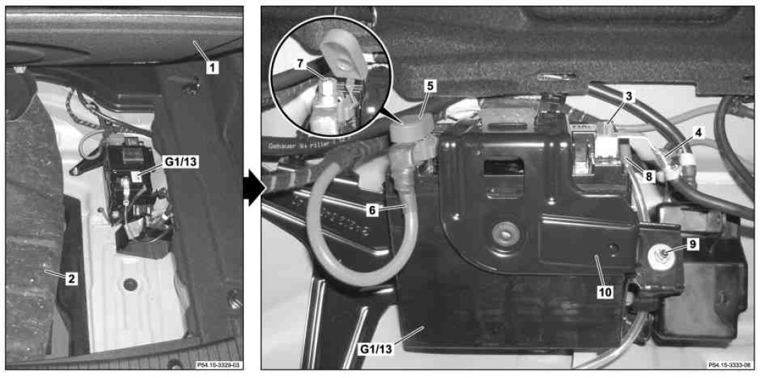

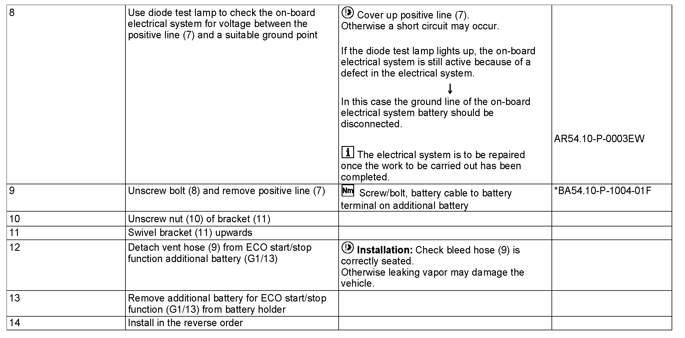

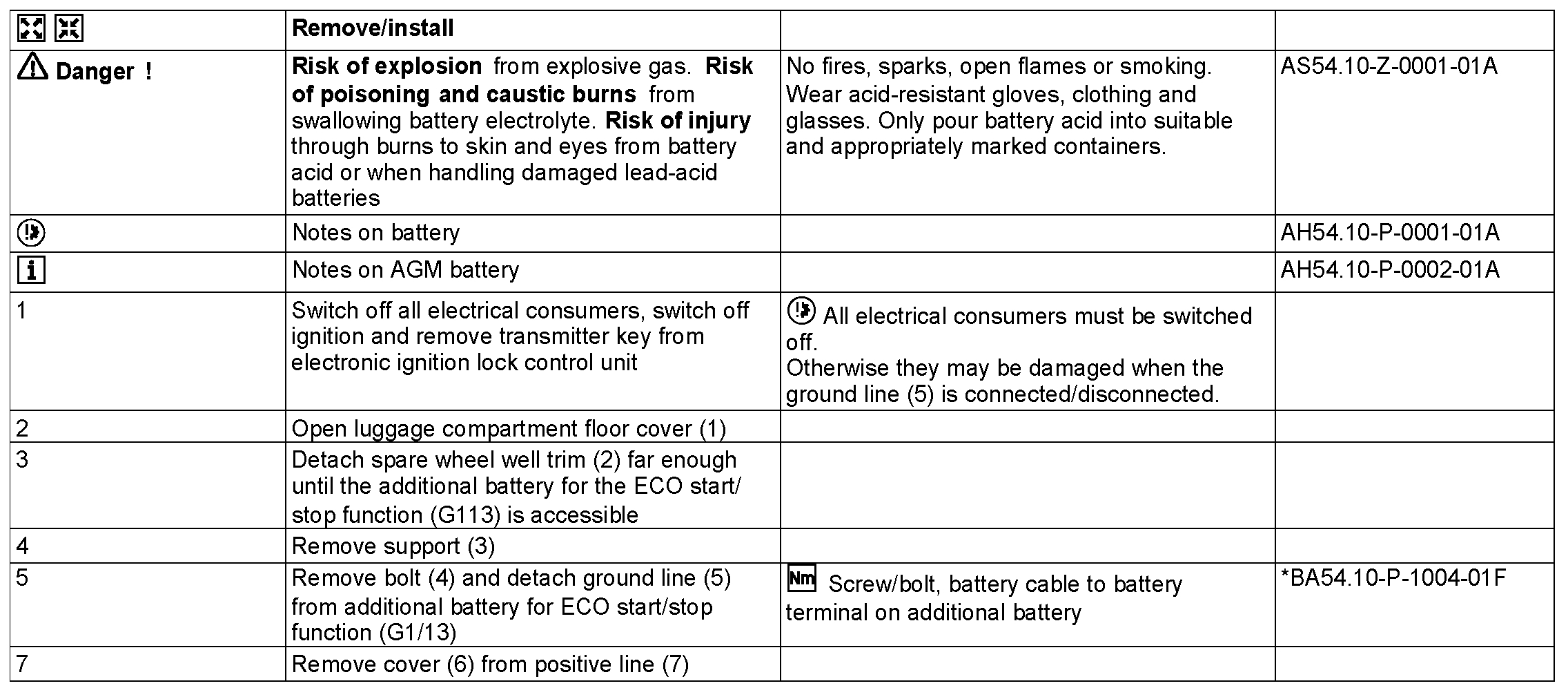

You will need to replace the auxiliary battery located in the trunk area. I've attached pictures with instructions.

Then yours may be mounted in the dash on the driver’s side. It’s the size of a power wheels battery, super small. The panel at the driver side knee area and the small panel on the left side of the dash accessible when you open the door, pop the panel out and remove the 10mm bolt and the battery will drop down so you can grab it from below the dash. Some E classes have it in the trunk area and some on the driver side dash area.

Hello, just wanted to jump in as well. As BMDOUBLE stated earlier, the auxiliary battery should be in the luggage compartment. Mercedes gives a poor diagram as to the exact location but it looks like you will need to remove the trim covers to actually see it?
