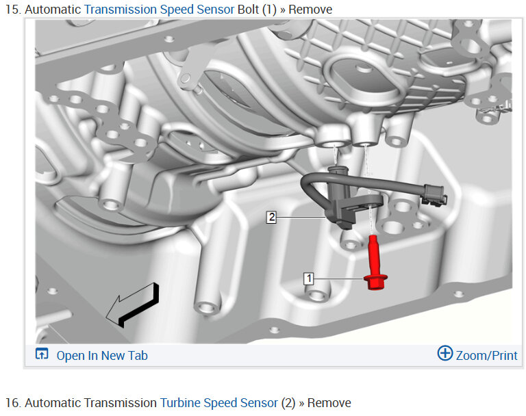

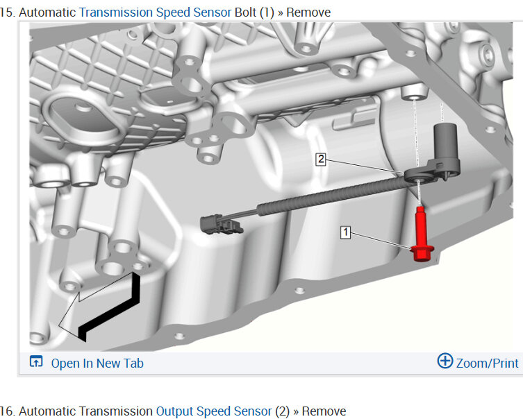

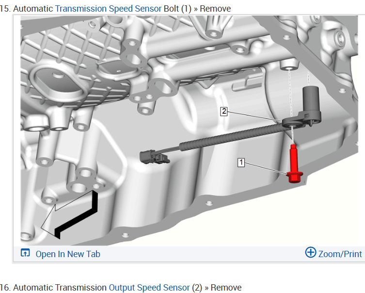

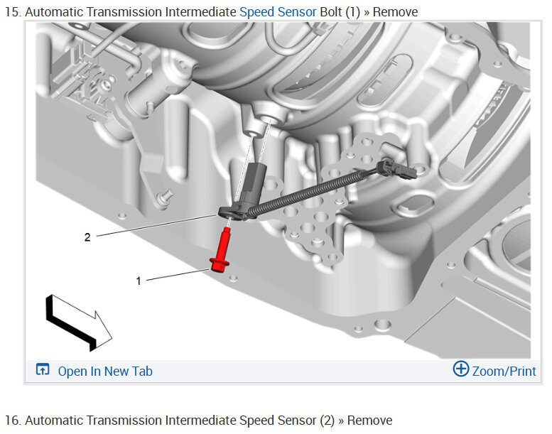

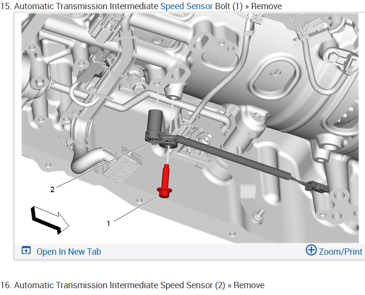

10 speed transmission? If so, this unit has an output shaft, input shaft and two intermediate shaft speed sensors which all require the valve body to be removed. Here are the location of the sensors so you can check it out. Check out the images (below). Let us know how it goes.
