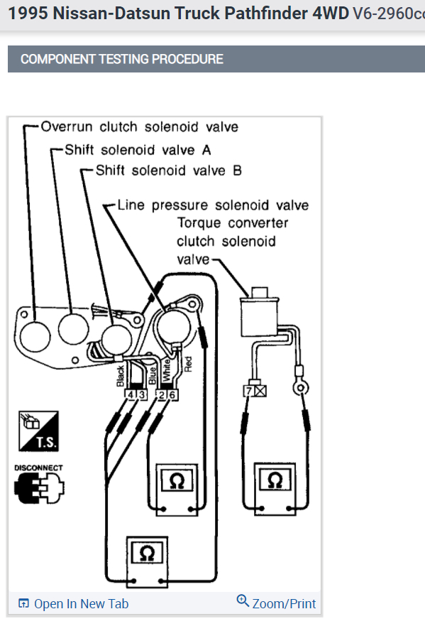

Please run down these guides and report back. i have also seen the pressure regulator sednoid go out as well. Check out the diagrams (below). Let us know what happens and please upload pictures or videos of the problem.
