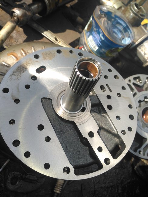

sorry my car is Mitsubishi Pajero Junior imported from Japan. After tearing it apart by professional the transmission oil pump looks like it made a groove. can this groove make the oil pump to fail and not circulating ATF oil?

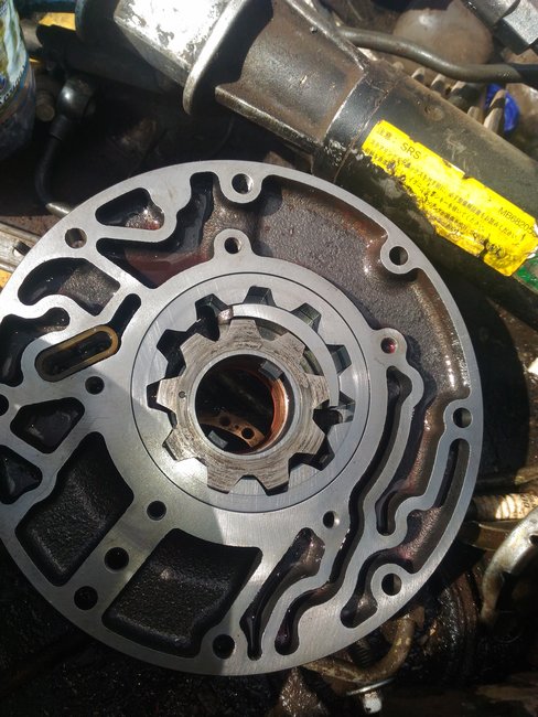

The second image looks also have a groove.

Those grooves are not normal wear, but it is doubtful they are the cause of this problem. Those would have developed gradually over time. Your transmission stopped working instantly. These grooves also will not cause fluid to leak onto the ground. If anything, it would make more sense an external leak occurred, then these grooves formed due to lack of lubrication caused by lack of fluid.
