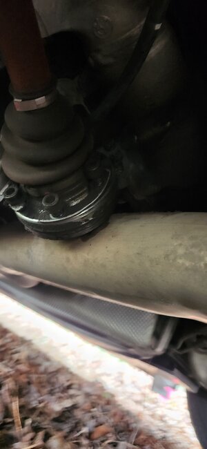

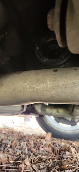

MOMMAAINTHAPPY
Hi, Car Guys! Thanks for the help. Here’s what I can see. Clearly something is broken. :( What is it?
Mar 10, 2023 at 10:37 AM
Oops, you found it, that is broken CV axle bolts. The broken bolts will need to be removed and replaced. Thanks for the image and getting back to me. I am glad you found the problem.
