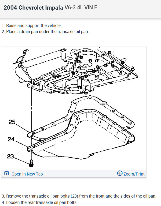

Sure, it is not too bad to let the excess fluid out just loosen the transmission fluid pan and it will start leaking. Use a fluid catch basin to catch the fluid. You may want to replace the gasket and filter as long as you are there. Also, I have seen people use a fluid extractor with a thin tube and feed it down the dip stick tube and suck it out that way as well.
This guide can help:
