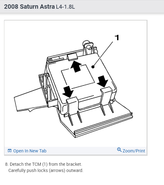

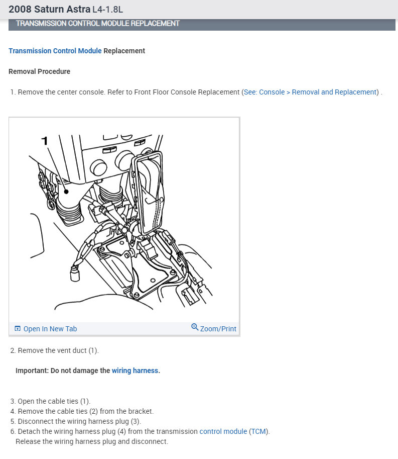

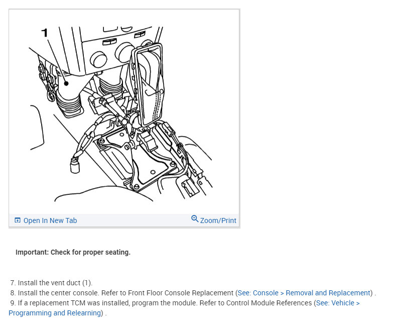

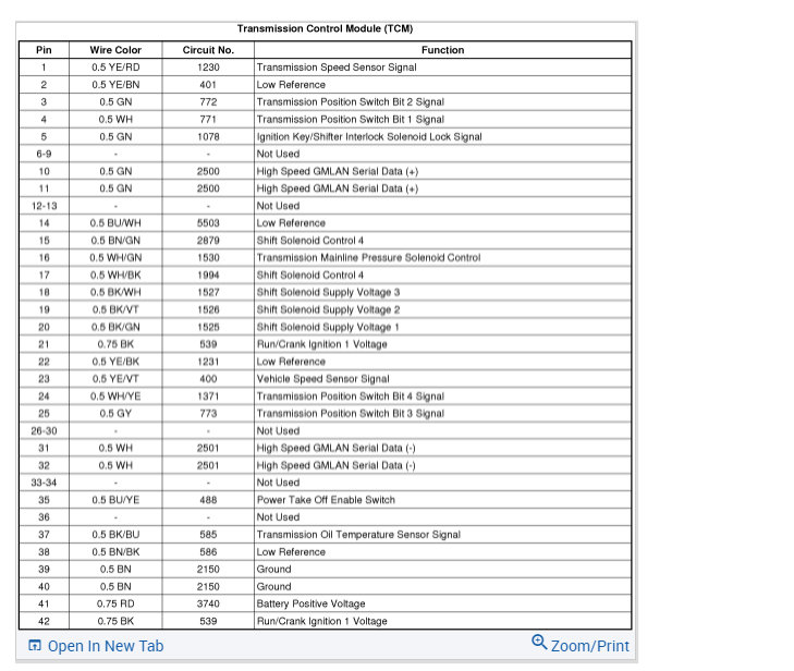

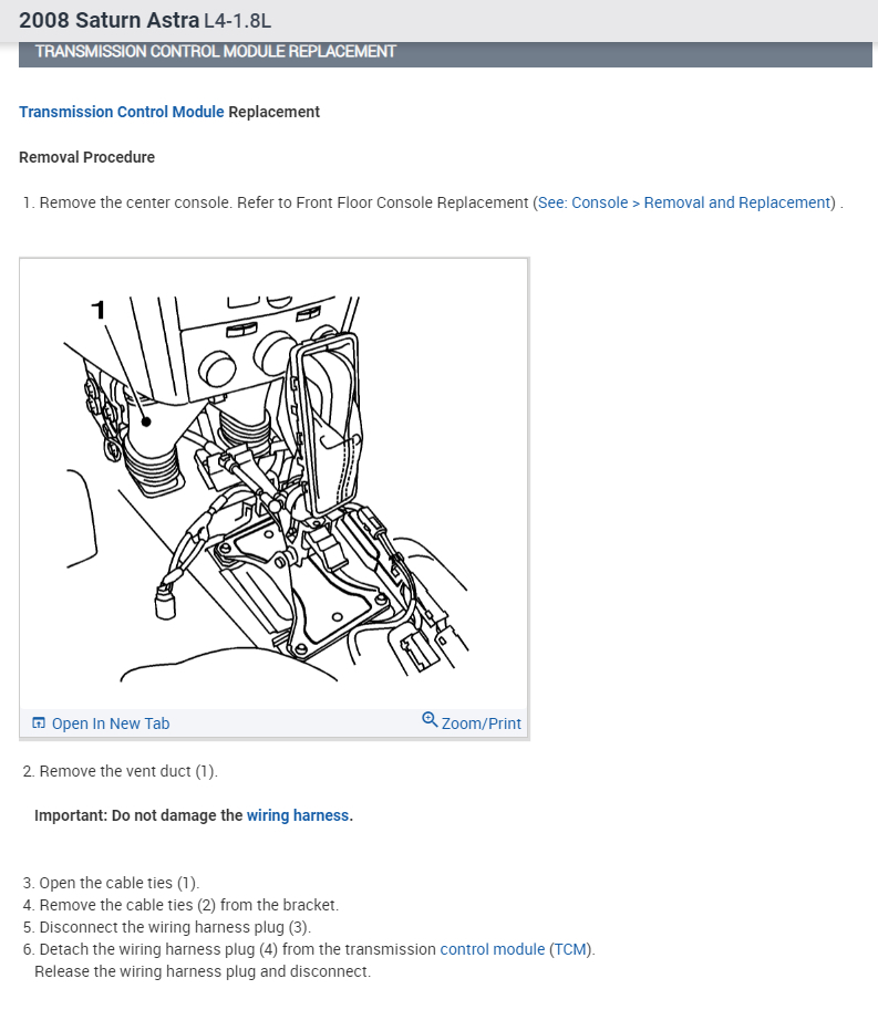

The transmission control module (TCM) is located behind the center console.

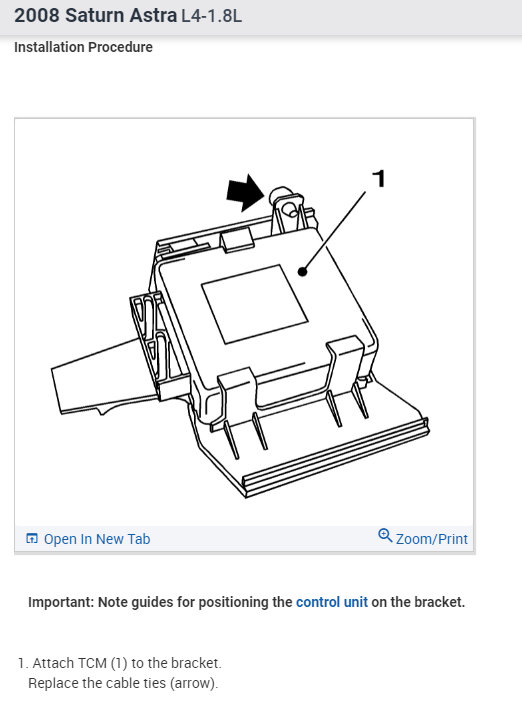

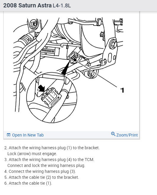

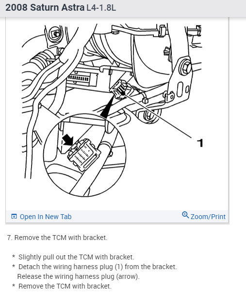

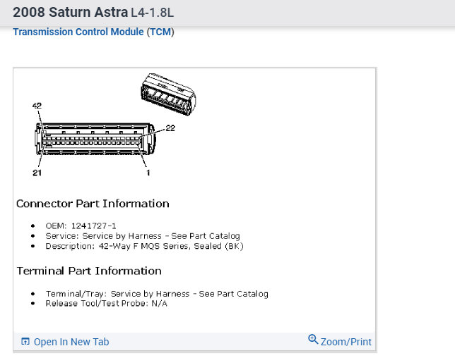

I have attached the replacement procedure for a 2008 Saturn Astra, which is similar to the Holden Astra, as Holden was not sold in the USA.
Keep in mind that if the TCM gets replaced it will need programming. Which will require a specialized scan tool.
