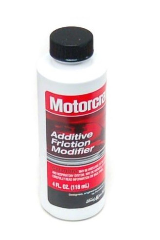

I attached a picture of what this looks like. It is just a 4 ounce bottle that you pour directly into the transmission. It is actually made for rear ends so that when you replace the new clutches in the rear, they don't chatter.
This has worked on many different vehicles but I would only add one bottle. Too much and the clutches can get prematurely fail.
