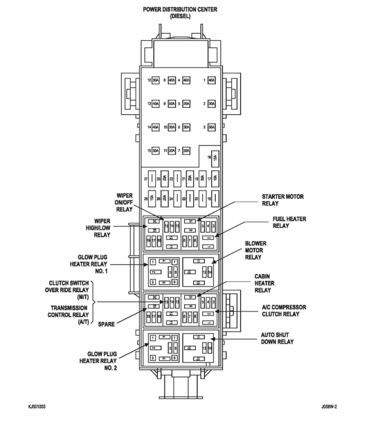

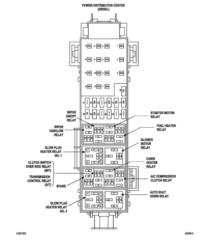

It sounds like the transmission control relay is going out. here is the location so you can check it out and a guide to help you as well:
