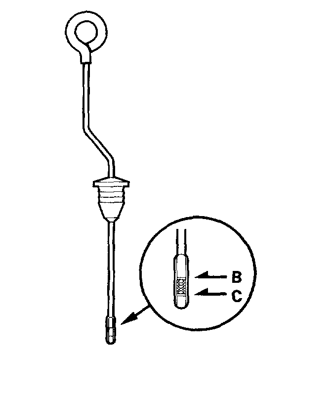

pic 1
3. Remove the dipstick (yellow loop) (A) from the transmission, and wipe it with a clean cloth.
4. Insert the dipstick into the transmission.

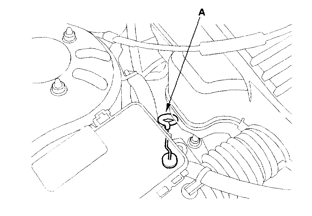

pic 2
5. Remove the dipstick and check the fluid level. It should be between the upper mark (B) and lower mark (C).

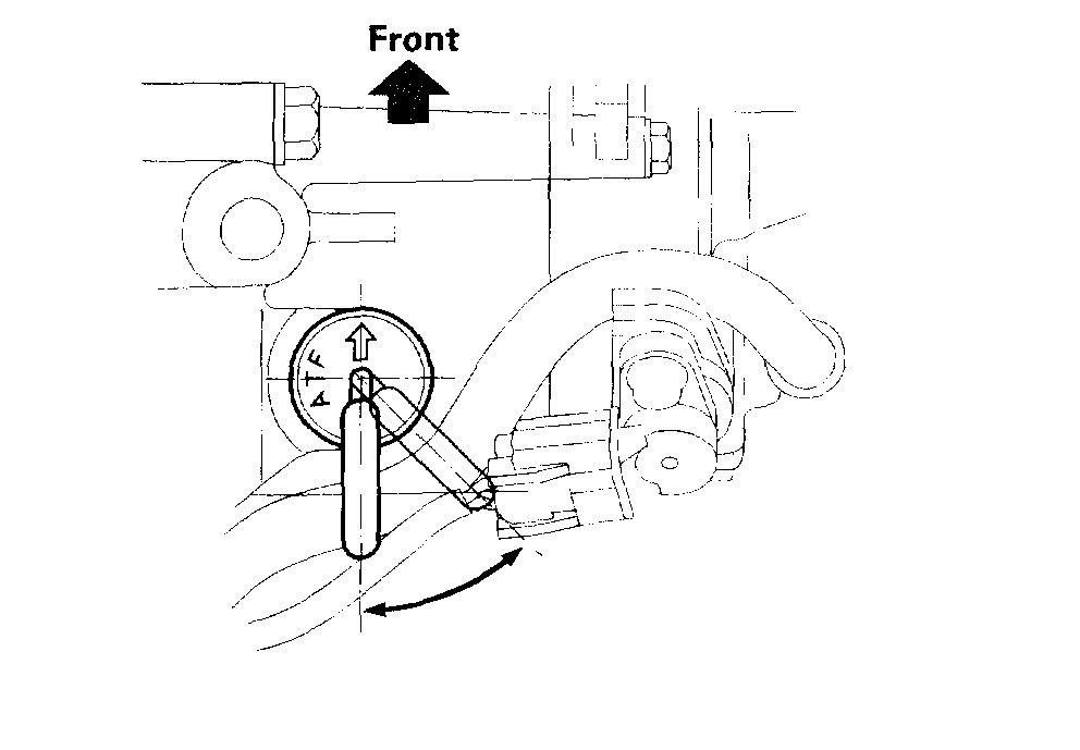

pic 3
7. Insert the dipstick back into the transmission in the direction shown.
