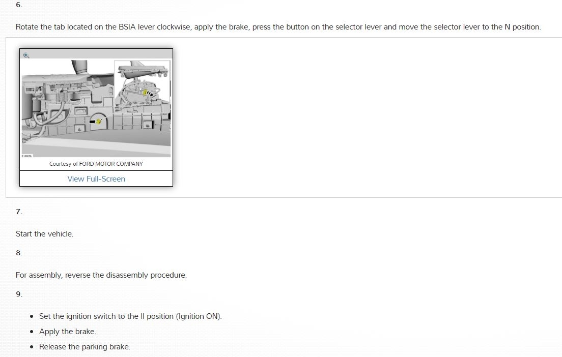

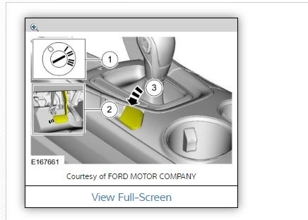

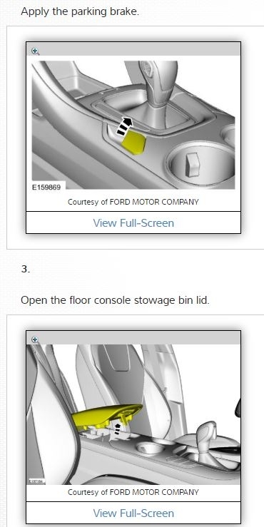

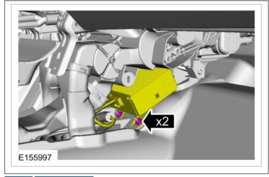

Make sure your brake lights work. Check for any trouble codes then try this brake shift interlock override.
May 12, 2018 at 7:25 AM

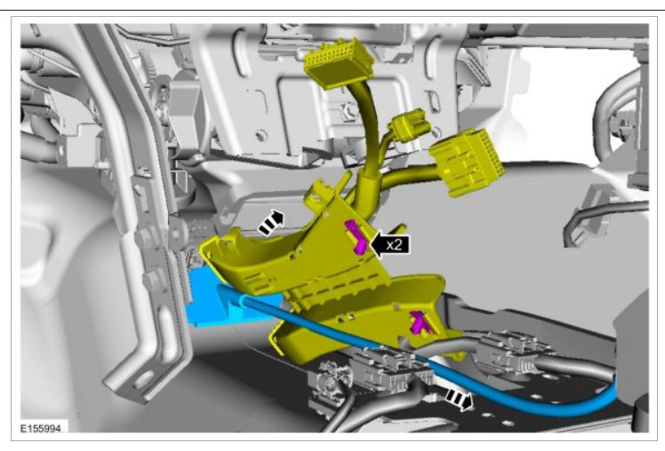

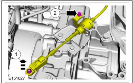

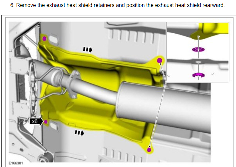

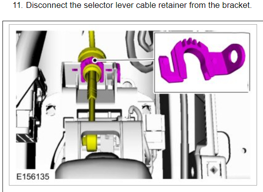

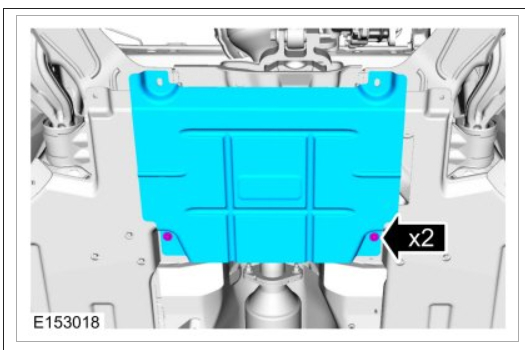

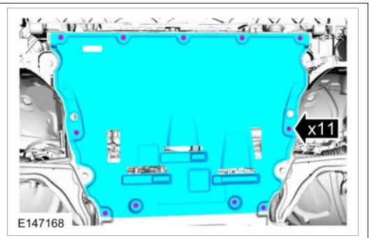

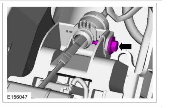

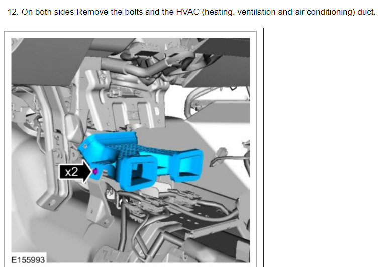

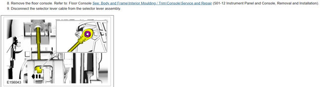

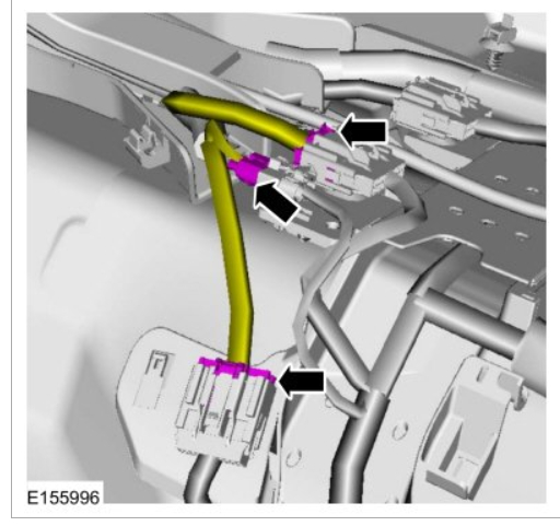

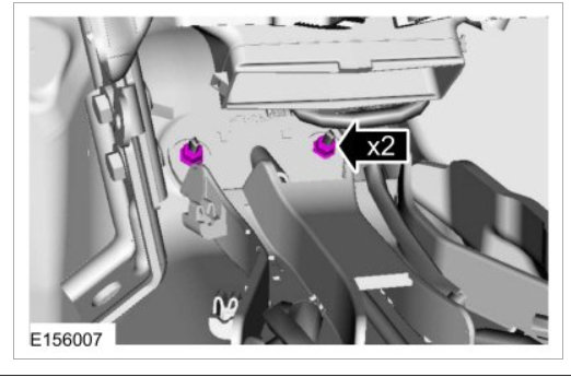

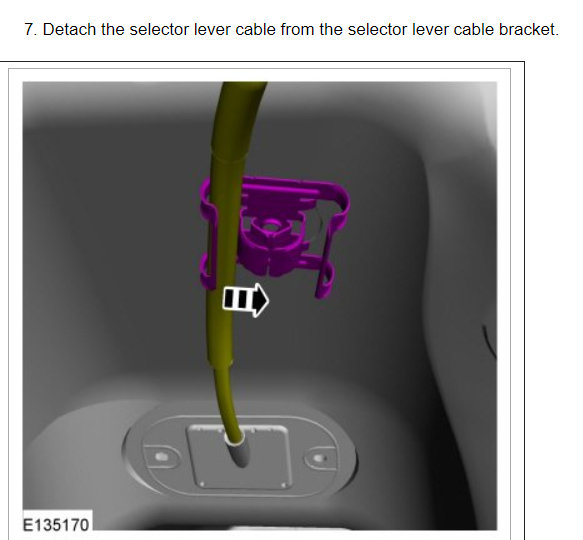

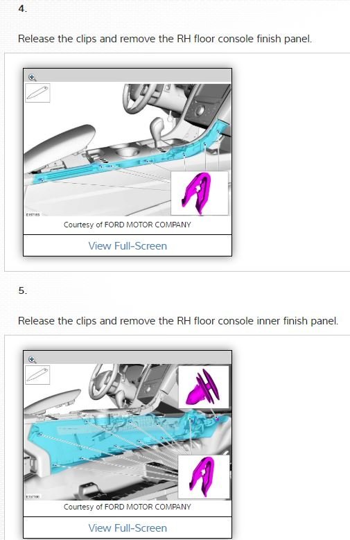

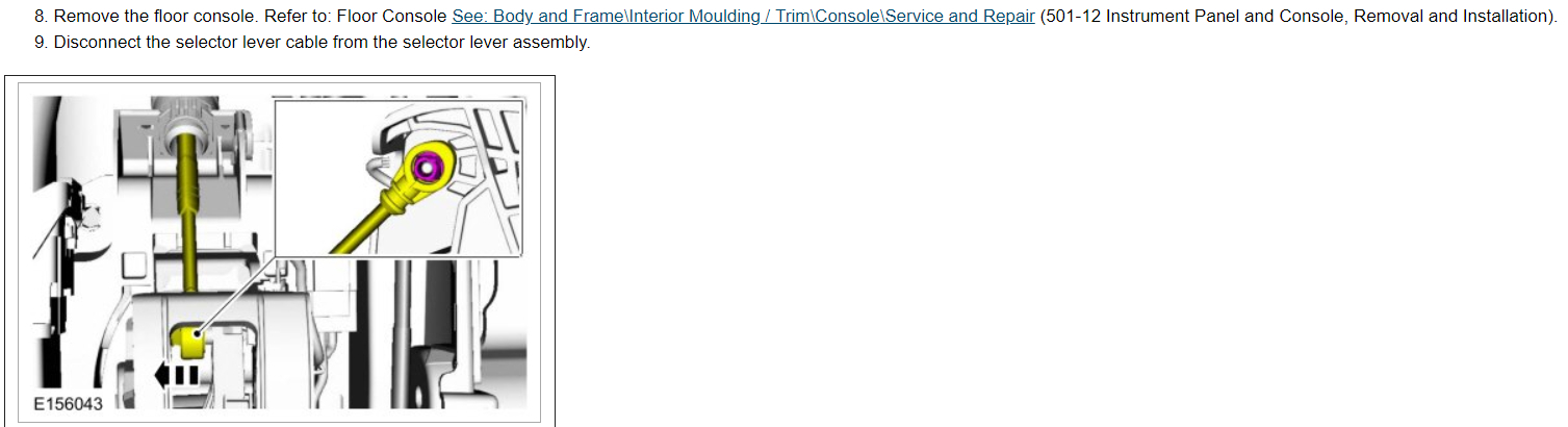

This sounds like you lost the shift cable. Have someone watch the transmission gear selector arm while you move the shifter to confirm the issue here is how to change the shift cable out.
May 13, 2018 at 11:06 AM
