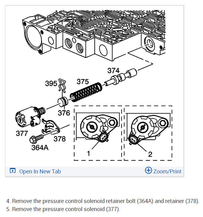

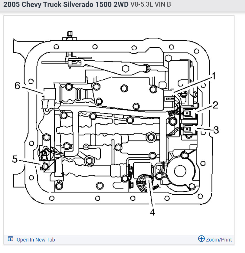

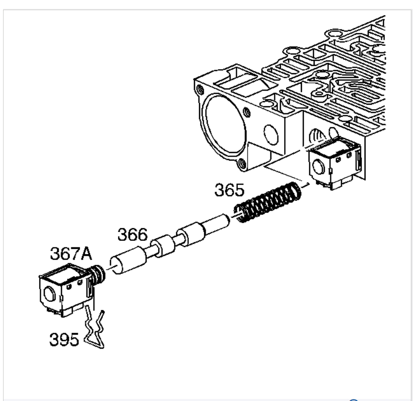

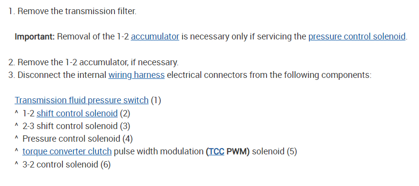

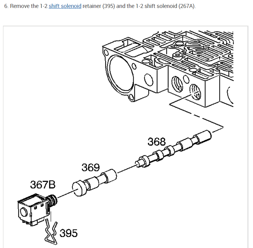

We should run the codes because it sounds like the first gear shift solenoid is not working, this guide can help, and I have included how to change the shift solenoid out in case a code is present for it.
This guide may help as well:
https://www.2carpros.com/articles/automatic-transmission-problems
Check out the images (below). Please upload pictures or videos of the problem so we can see what's going on.
