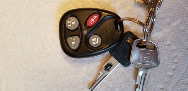

The key fob looks different than any pictured on the web. Working lock/unlock buttons on top, red alarm button on the bottom right (works), a round "GM" button on the bottom left that eventually opens the trunk if it's held down. And a really small dot (1/32"?) right in the center that looks like a "reset" point button. Haven't pushed it yet. May not be anything. GM Corp Customer Service says they cannot look it up using the GM part number on it. That it's too old.

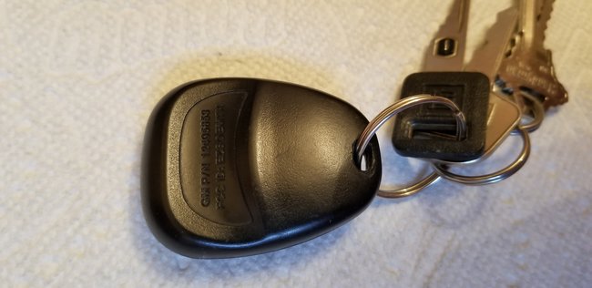

It is an OEM system. I took the car out for a long run in a steady cold rain and tried every function at least twice. It all works, no hesitations or fails. Locking and unlocking the doors with the remote does chirp the horn as on other programmable vehicles. The auto lock feature will trigger after engine start, or with the key in the run position. The auto unlock triggers as the key is moved off of the run position. This occurs in both "park" and "neutral" while moving the key to start or run.
The shift lever is not sloppy. It doesn't change this if the shifter is held firmly against either side of the "park" position . The photo of the key fob shows the little dot in the center. I'm wondering if anybody knows if it has a function. The key fob works okay. The GM button operates the trunk release.

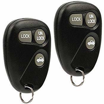

That key fob is an aftermarket replacement, probably purchased off of Amazon or Ebay for a few bucks. An OE one would say "trunk" on the trunk release button, not "GM." Plus the buttons aren't even a little worn off, like they normally would be on a twenty year old fob. If I had to guess, I'd say that the button in the middle has something to do with syncing it to the car.
As others have told you, I can't seem to put my finger on exactly what's going on. An educated guess would be that it has something to do with the way that fob is programmed to the car. Perhaps re-syncing it would help. Check this video out for instructions: https://www.youtube.com/watch?v=b81j97xZ7PE

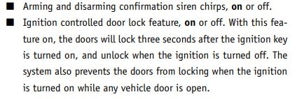

Hate to be the bearer of bad news, but that remote is one of the ones used on a dealer installed "accessory" alarm system, not one that was the built in factory option. The OEM factory installed Lumina remote is the 3 button unit in the attached image.
The dealer installed item was a 4 button remote from Directed Electronics that controlled the DEI after market alarm and key-less entry unit. The small "button" in the center of the remote you have should be a red and green LED that responds differently depending on which options are installed and enabled in the control box. It is somewhat of a generic unit that dealers sold as an upgrade and was installed by them on vehicles that didn't have the factory system or that didn't have an alarm with the factory system to give you key-less entry and an alarm, The 3 second auto-locking option is a DEI common feature. The second image shows a section from a model 425 guide showing that option.
Most of the DEI units have a model and serial number that can be looked up to get instructions on the unit. The OEM units like yours are adapted from one of their consumer models and sold strictly to dealers. They included branded remotes to make them look like a factory item but they really are not. Some used internal switches to select the options, others use a programming switch and the remote to program options and they also had units that used a special programmer box to set the options.
The controller will be installed under the dash, usually tucked up in the wiring or taped in place. It will have 3 to 4 wiring plugs on it that connect it to the vehicle.
DEI has been around a long time, they make the Viper, Python, Auto Start and many more alarm and remote start units. https://www.directed.com/

After dealing with a few hundred of these things installed by the "professionals and dealers" in this area I will withhold my full opinion on them, suffice it to say that it is somewhat lower than a snakes belly.
As for finding the who behind may of the systems the FCC ID on the outside will usually get you better information that the part numbers. If you open the remote up like you are changing the battery there are many that have the makers information on the circuit boards as well.
Your FCC id starts with EZS which is a DEI code, Then the OEM which says it's a dealer installed item built for a particular company. The part number tells you the OEM in this case is GM.
There are a few companies that do these for the OEMs. The question then becomes "Was the guy installing them any good?" In this I have seen everything from a quality install where the wires were trimmed and soldered with self seal shrink tubing and the unit installed on a bracket with proper materials. Others were full length wires with connections made with scotch locks and zip tied in place and the lowest forms had the wires just twisted together and taped with the units just stuffed up under the dash behind the harnesses and just hanging there.
Same things happen these days. One of the first things I look for on security or no starts is an after market remote start or alarm. Most have no real testing options so you look at the wiring and what it connects to and try to bypass them as needed.
