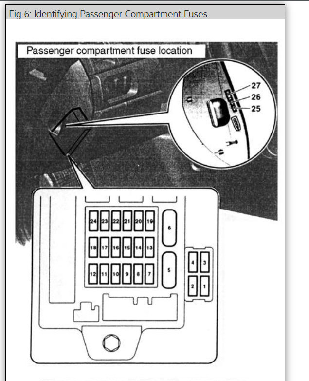

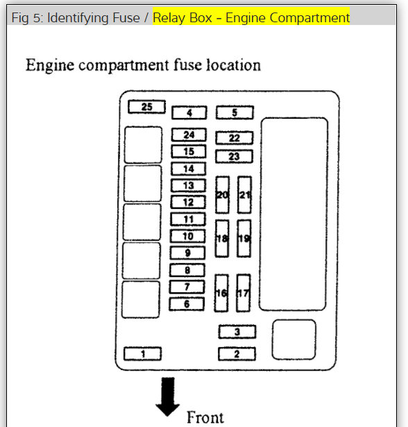

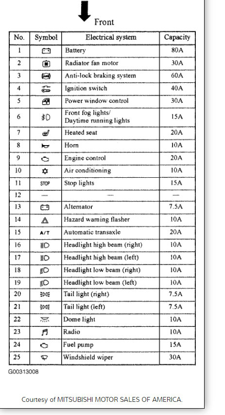

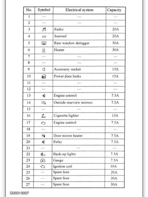

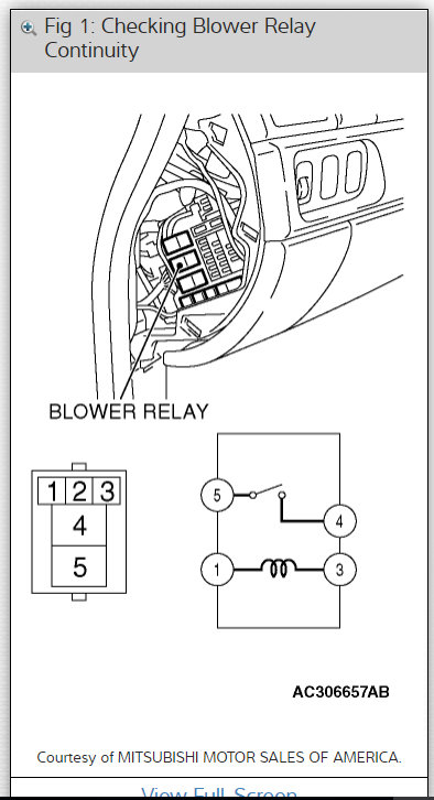

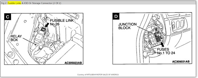

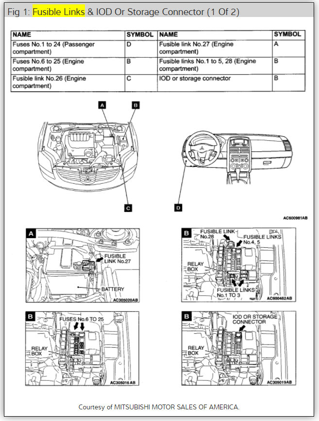

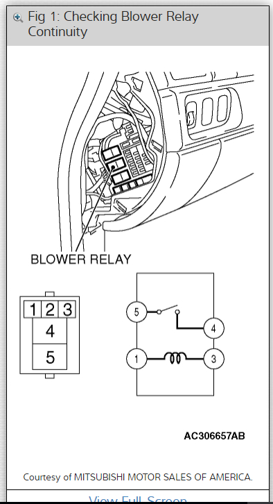

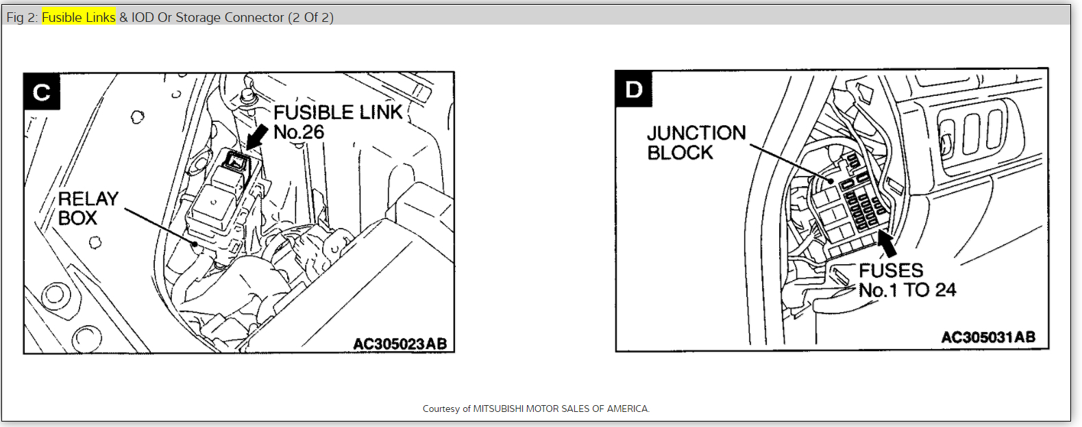

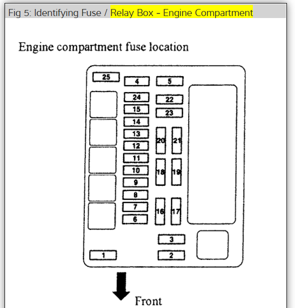

It sounds like you have a fan control relay that is stuck on. Remove the relay to see if it stops and if so here is how to test it to see if it is a trigger issue or the relay itself.
Check out the diagrams (below).
