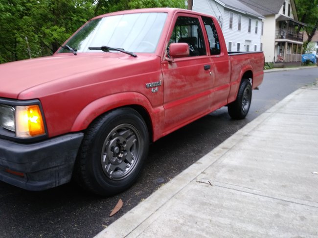

There are people who can do these types of modifications, but I can guarantee you I am not one of them. I have done engine swaps years ago, and I built a mid-engine Dodge Challenger for racing. It had to be street-legal, and it was real fun to drive, . . . as long as I did not have to go around any corners. It had no heater, no AC, no speedometer, no carpet or interior for sound-deadening, and only a six-gallon gas tank, so I knew if it broke down, I would not be any further from home than I was willing to walk back! I worked every night and every weekend for six months to build that car, then I got to race it four times before my girlfriend at the time crashed me into a pile of smoldering ruble. The car is still sitting behind my house for the last thirty years. You are today where I was thirty years ago. Had I known then what I was in for, I never would have considered doing most of those projects. I wasted so much time and money to build scrap metal. We read about these projects all the time and how they go sour. I am trying to convince you to avoid that heartache.
I did replace the smaller automatic transmission in my 1978 Chrysler with their larger model, but I knew that everything was the same except for a slightly shorter driveshaft. The car had been available with that larger "727", and all the mounts, linkages, and hose connections were the same, something Chrysler was famous for. Basically I replaced an orange with a slightly larger orange, and I called it an orange. You are trying to replace a pumpkin with bench grinder so you can call it a chair.
Sorry, but I had to add some humor to this sad situation. Normally I would recommend you get a copy of the manufacturer's paper service manual, but in this case that will not tell you what is different. Sometimes they will show you a line drawing, and it will have an arrow pointing to an item listed as "with automatic" or "manual transmission only", but only when it is pertinent to the subject being covered. Even if you do figure out a part such as a bracket is different, you will not know why, or if you can work around that difference. Experience is the best teacher for that, but you are not going to find many people who can supply that knowledge.
If I have not convinced you yet, find a truck with a manual transmission in a pick-your-own-parts salvage yard, then compare it to your truck. Look at how the clutch pedal is mounted and whether you will need to replace the brake pedal to make room for it. If the mounting bracket is not in your truck already, you could end up replacing the entire dash board. You will probably want to own the donor truck so you can remove parts as needed. If you have to keep running to the salvage yard, you will spend more for parts than what the finished truck will be worth.
The only reason I can think of to attempt this is if the truck has sentimental value, but then you would want to keep it original. For practical purposes, there is no need to complicate your life unnecessarily. Buy what you want. Neither of us is better at building a vehicle than the manufacturer.
