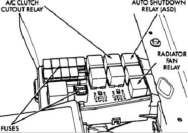

Off again, on again starting problems. Stutters and stalls. Replaced fuel pump, worked great for a day. Auto shutdown relay location needed.
