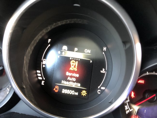

Hi, I have an error on my car that says "Service auto Headlights". They are always on even under the sun when the switch is positioned on Auto. Tried switching the twilight sensor for a new one, but it did not work.Any suggestions?

Yes, once I turn the car off, the lights go off as well. They stay on when the ignition is on “on” or the engine running. I’ll try to scan the car again and find the code.

Nothing related to lights pops up. However, I think you are right; there is something going on with the BCM. Now it says "service power steering".

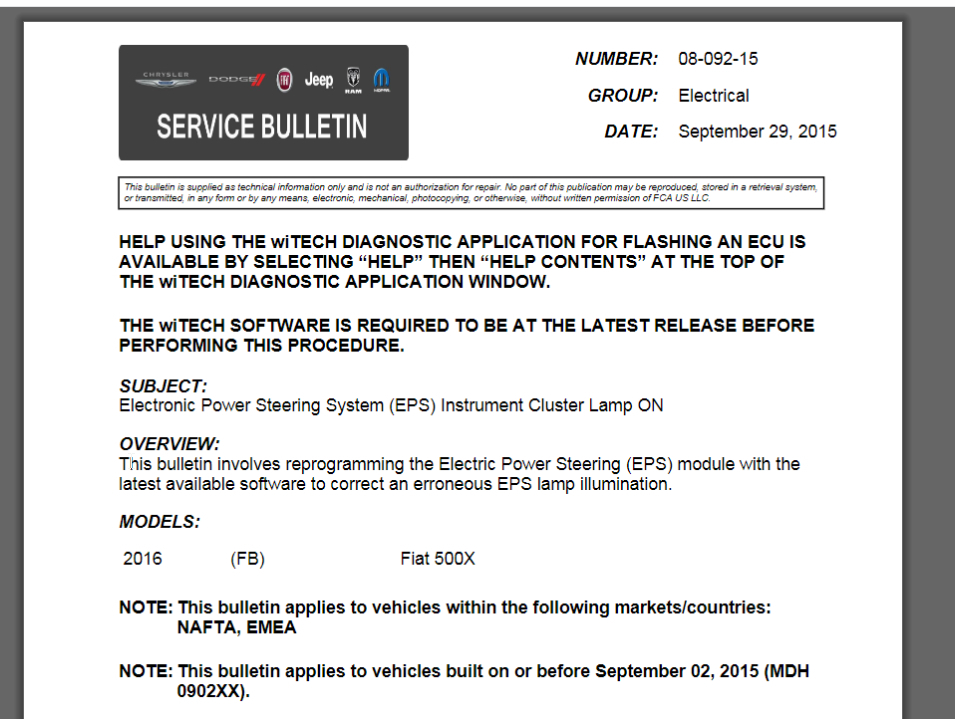

Okay. The fact that the vehicle drives properly then I suspect we have a software issue. Which lead me to look for a TSB and there is one that fits this concern. Unfortunately that means we will need to take this to a dealership so that this software update can be performed.
I suspect this software will address the issues you are seeing. Thanks

Understood. However, updates like this are not very costly. Most dealerships charge a flat fee to have all available flashes performed. I would just call and ask them how much they would charge to get all available flashes done. Then call a couple others and pick the cheapest dealership. There is only one way to do it so the cheapest dealer is the best in this case. They literally just hook the scan tool and perform the updates.
If we can get these done, I would be surprised if it didn't correct the issue.
