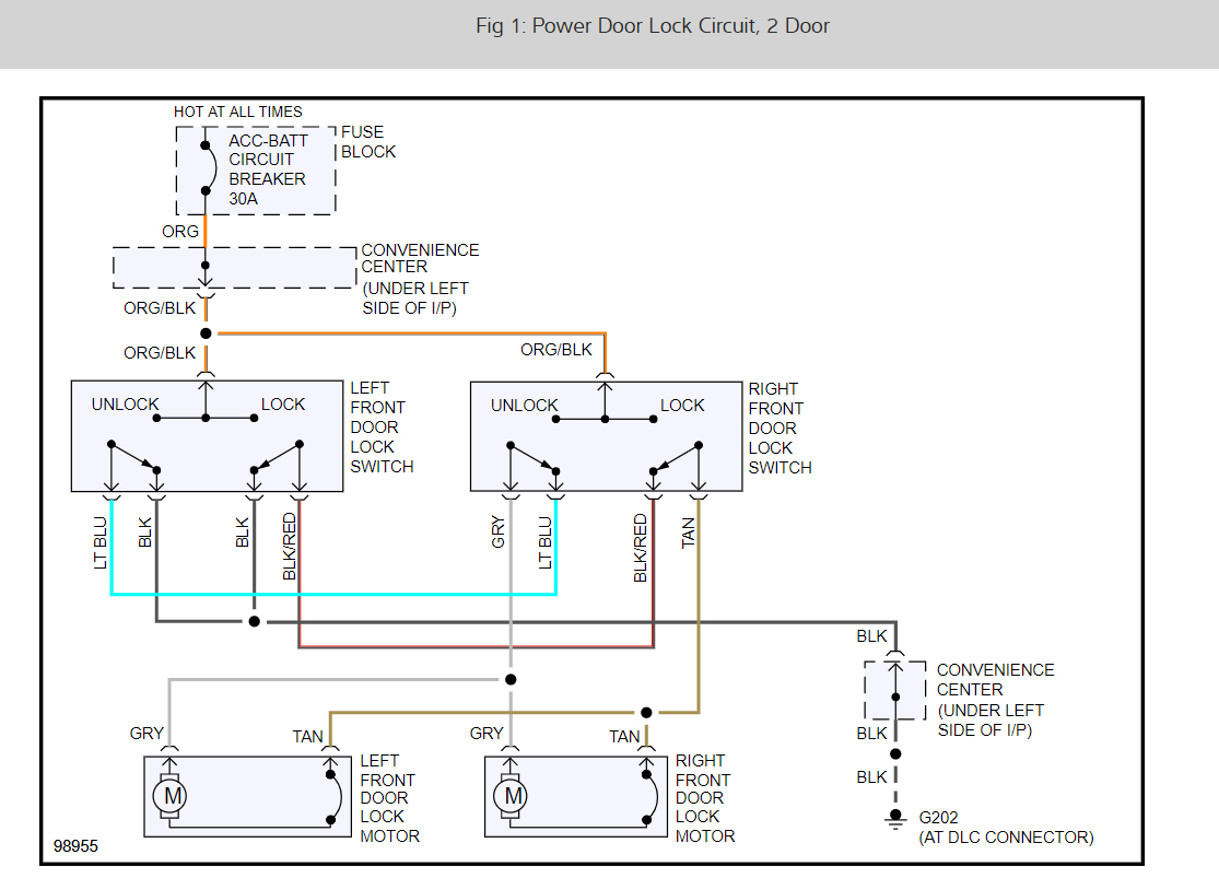

My automatic door locks stopped working. The drivers door can’t lock switch not working. What can be causing this?
Aug 24, 2019 at 8:38 AM
It sounds like the main switch when out. here is the lock wiring diagrams so you can see how it works and a guide to show you how to test for power. system is pretty simple here are the wiring diagrams to confirm.
Check out the diagrams (below). Please let us know what you find.
