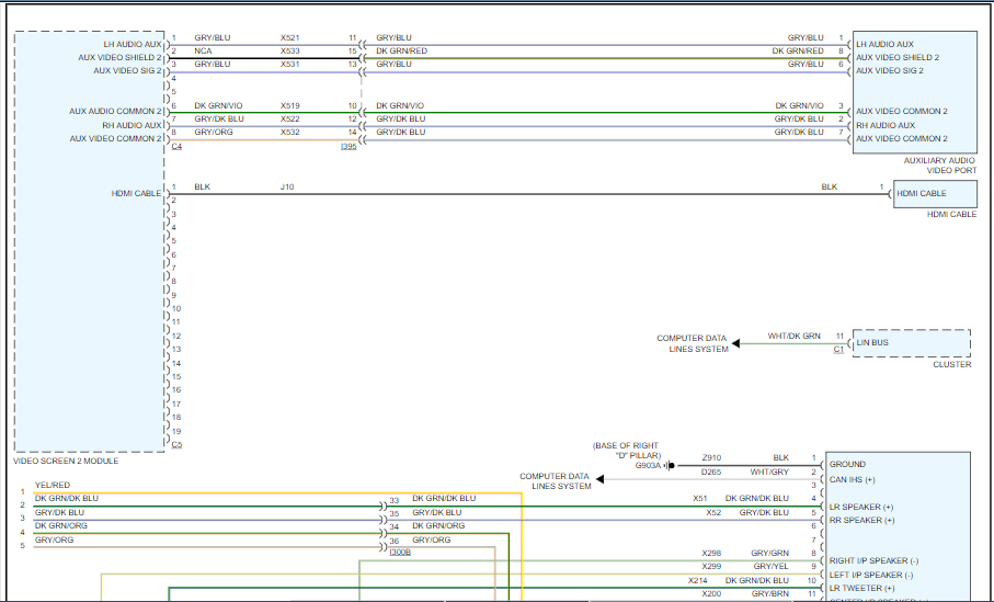

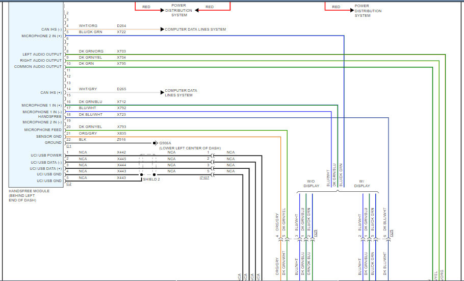

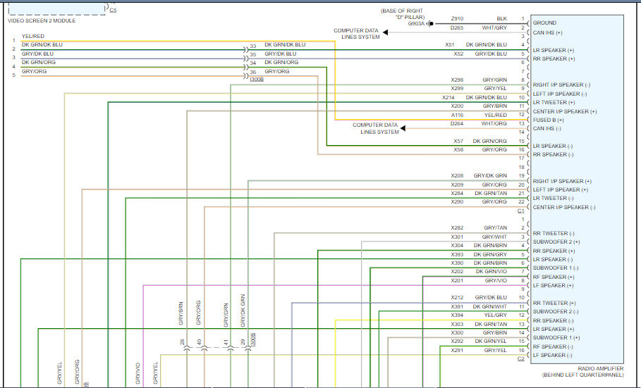

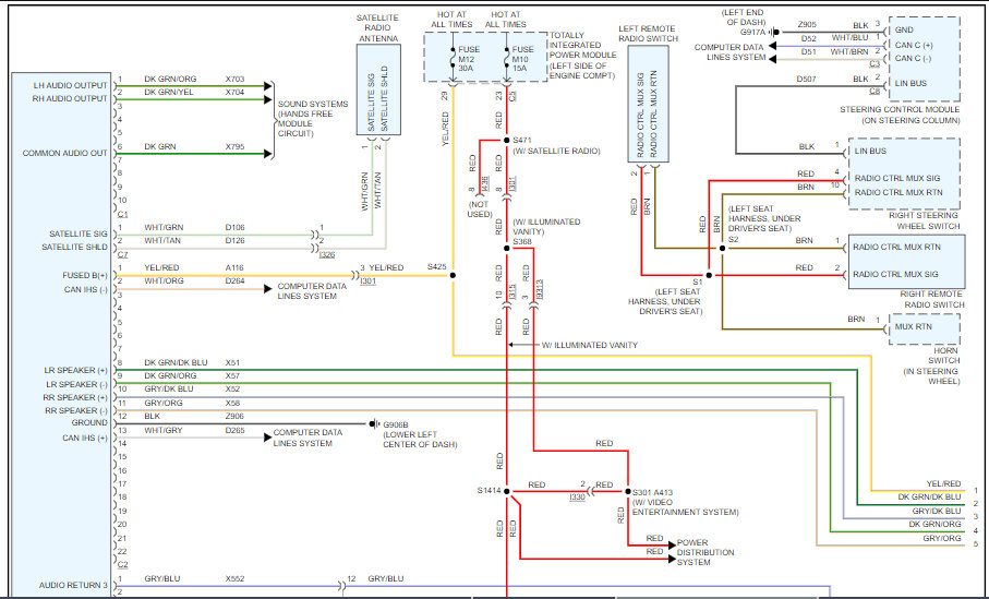

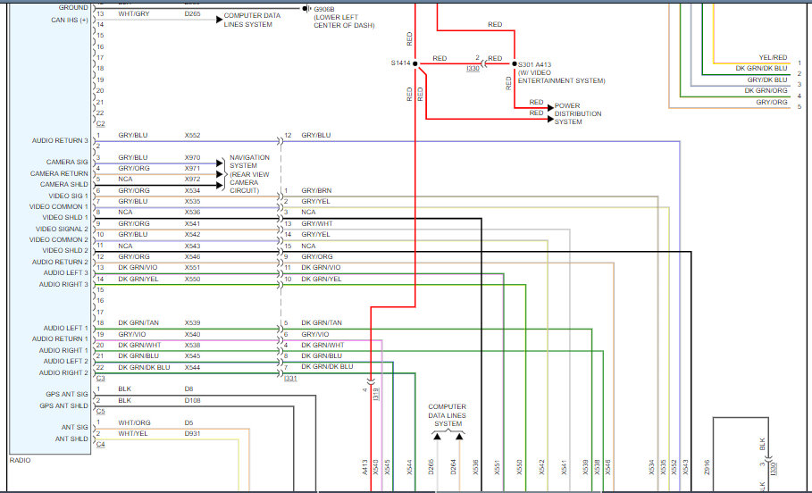

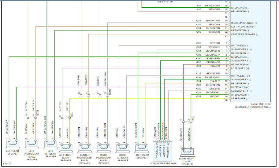

Looking for a audio wiring diagram for the GT premium 10 speaker system with pinout and color codes for the 430n radio.

I've attached the wiring diagrams below for the 10 speaker system and hands free module. I've cut the pictures into 3 pieces each so you can view larger. Hope this helps and thanks for using 2CarPros.
