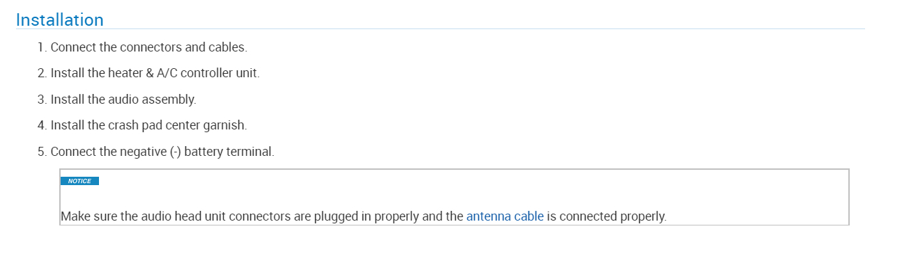

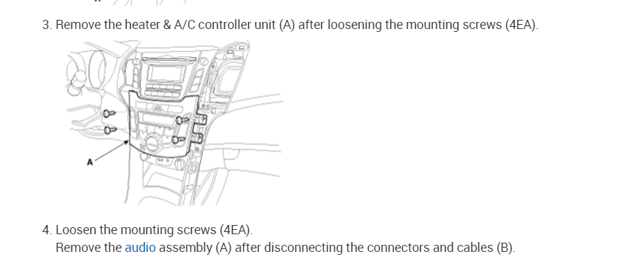

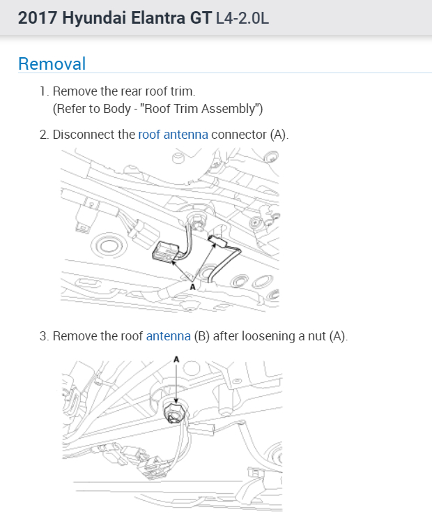

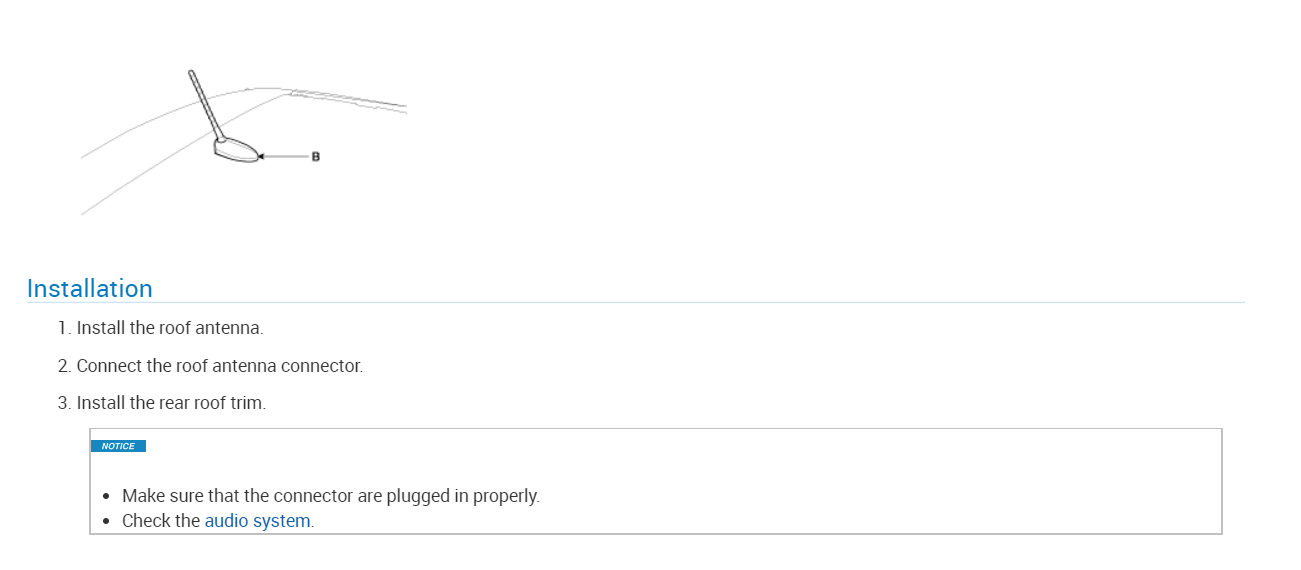

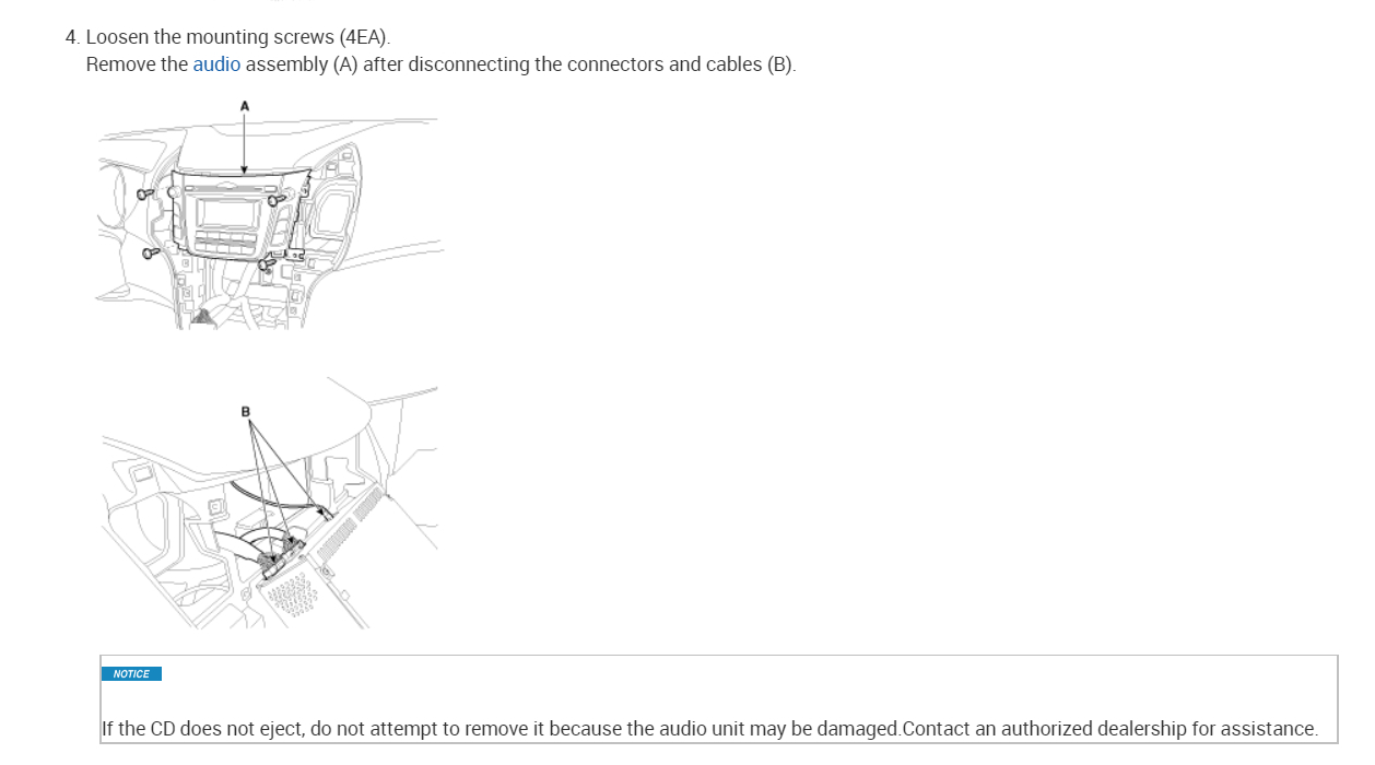

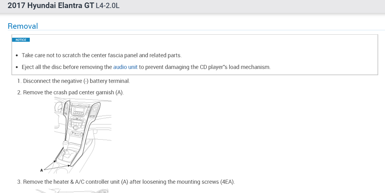

It sounds like the combination media antenna/Glass antenna is not working or going out. You might want to try to remove the radio unit and check the connections at the rear of the unit, if everything looks okay here is how to change out the radio antenna. Check out the images (below). Please let us know what you find. We are interested to see what it is.
