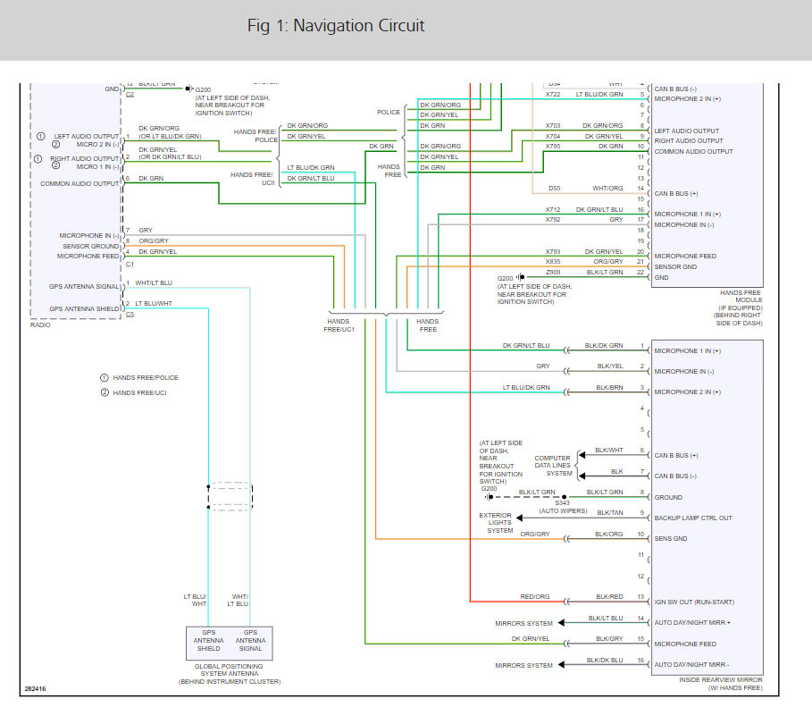

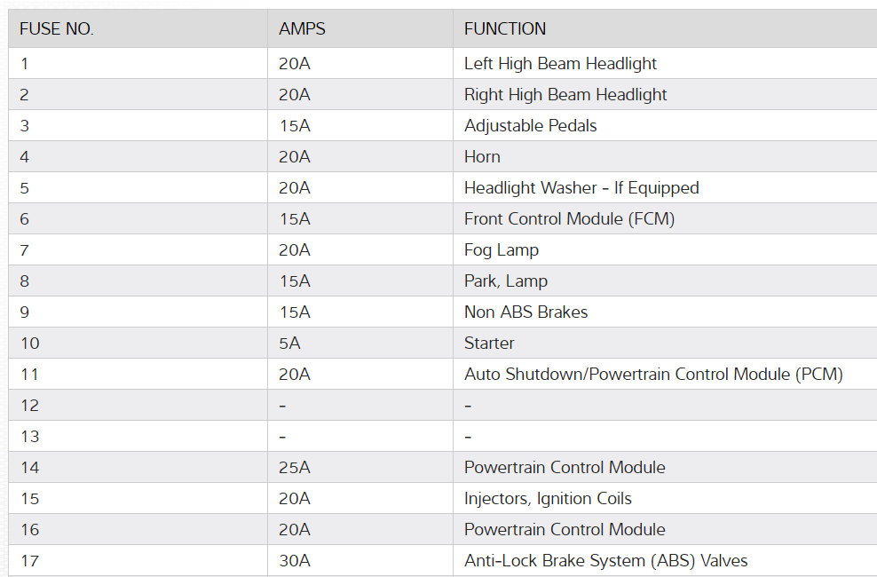

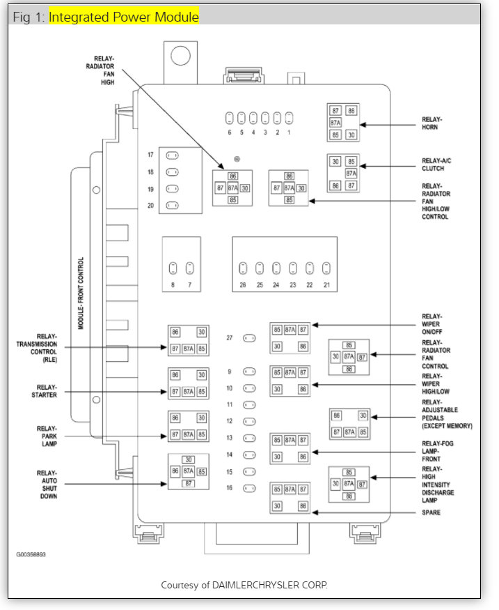

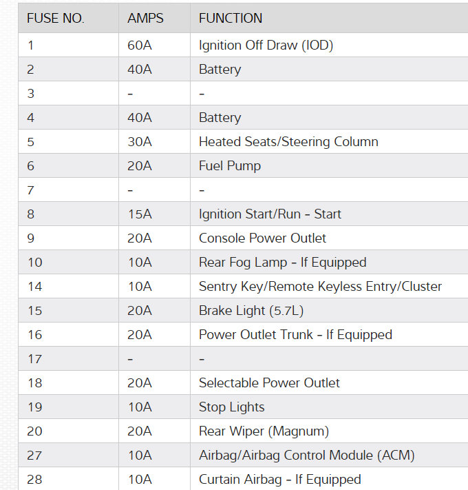

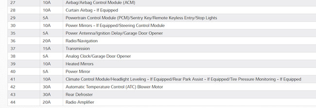

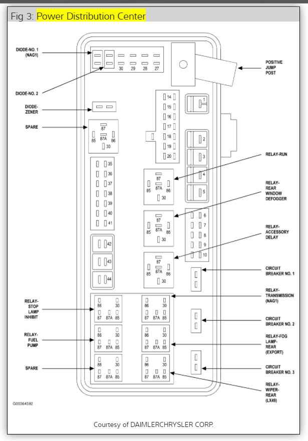

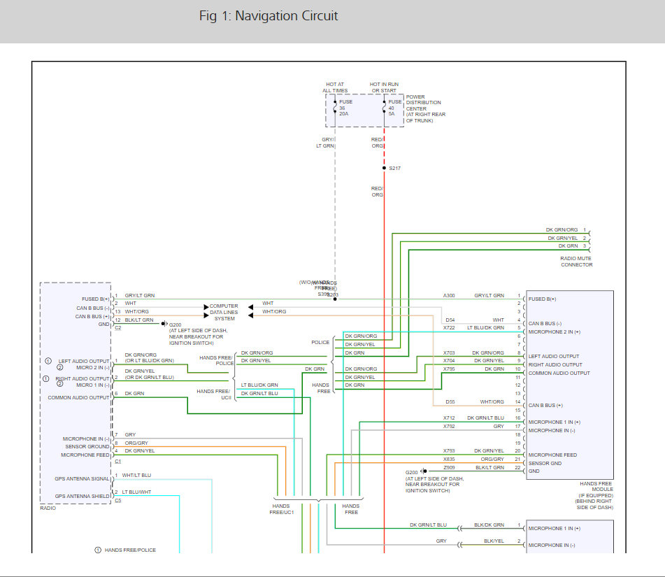

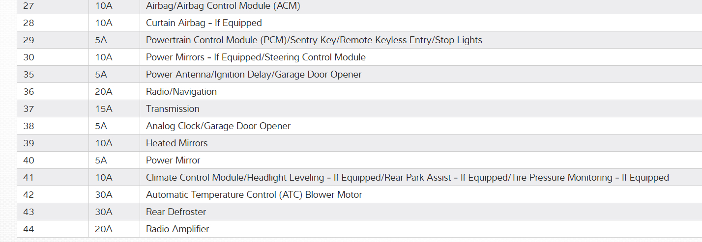

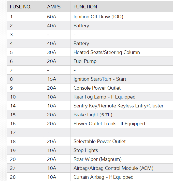

Lets check for power at fuses # 36 and #40 in the trunk fuse panel. Here is a guide to help and the NAV system wring diagrams so you can see how it works:
Check out the diagrams (below). Please let us know what you find.
Jul 11, 2019 at 11:02 AM

put new fuses in, nothing happened.
Jul 12, 2019 at 8:58 AM
Good job on the fuse can you tell me if the fuse has power? Here is a guide if so please check the ground in the same manner (switched to power) and if okay the unit is no good and needs to be replaced.
