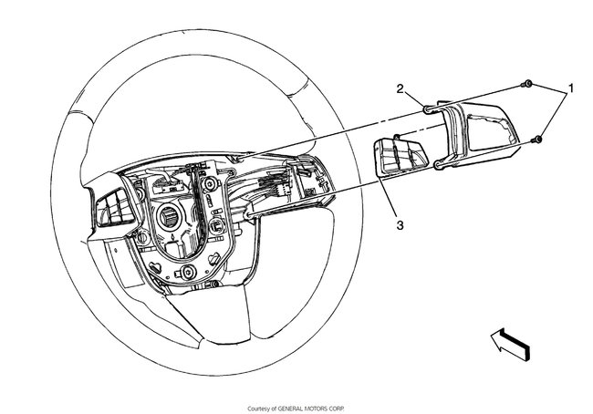

My audio controls on the steering wheel are loose. How do I go about fixing them?
May 9, 2016 at 9:14 AM
Hey James,

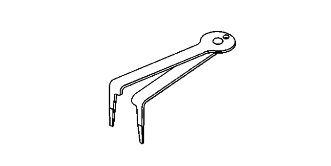

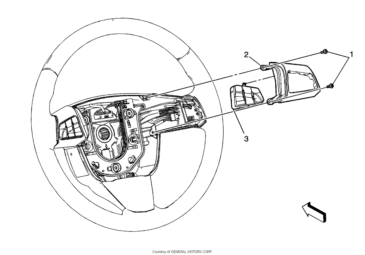

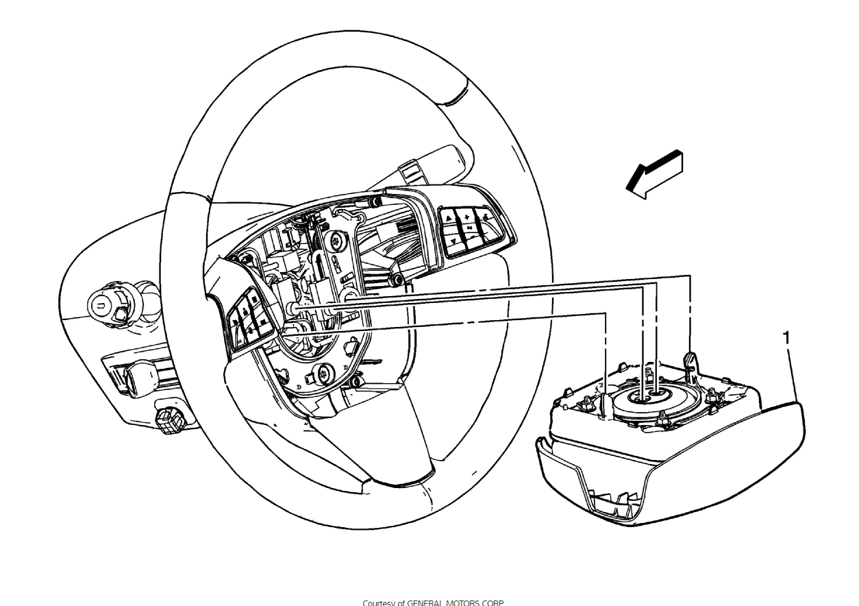

These control are held in place by small screws holding a plastic bezel that the switches are made from. You will need to remove the airbag then the fascia piece the gain access. Here are some diagrams, i tool will be needed to remove the airbag but I have done it without using two small screwdrivers or needle nose pliers. Let me know how it goes
Best, Ken
