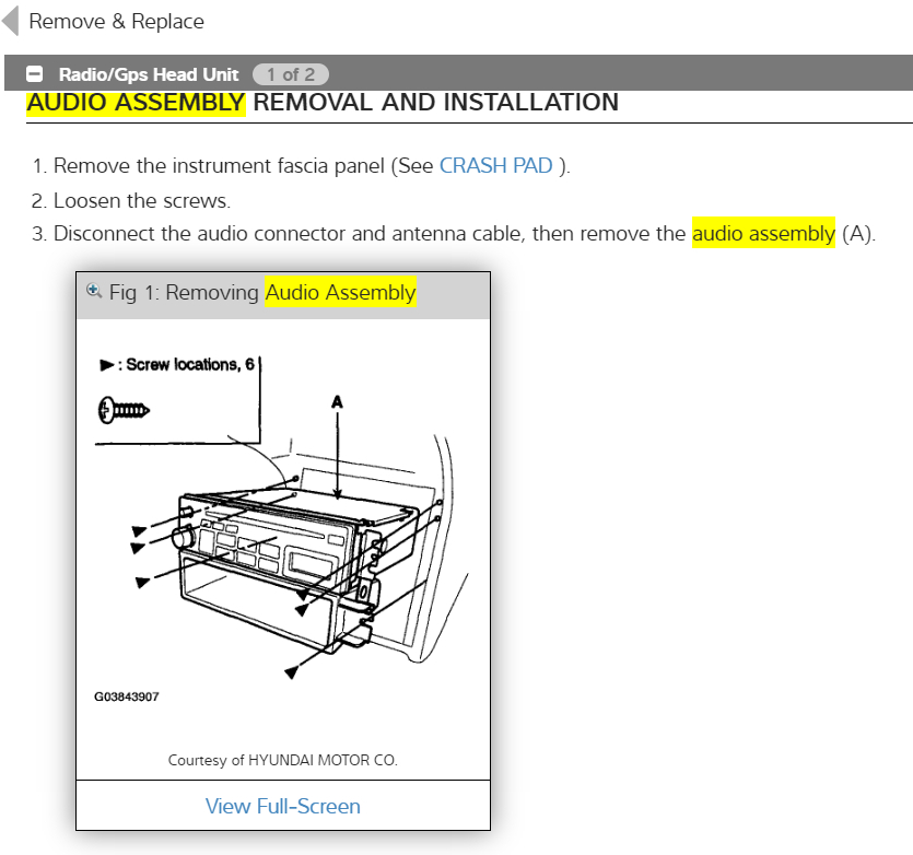

What are the steps for removing the stock radio?

If you can send me steps on taking out the stock radio. I purchased a Dual CD deck from Walmart for my car. I also purchased 18-gauge wiring for the speakers.

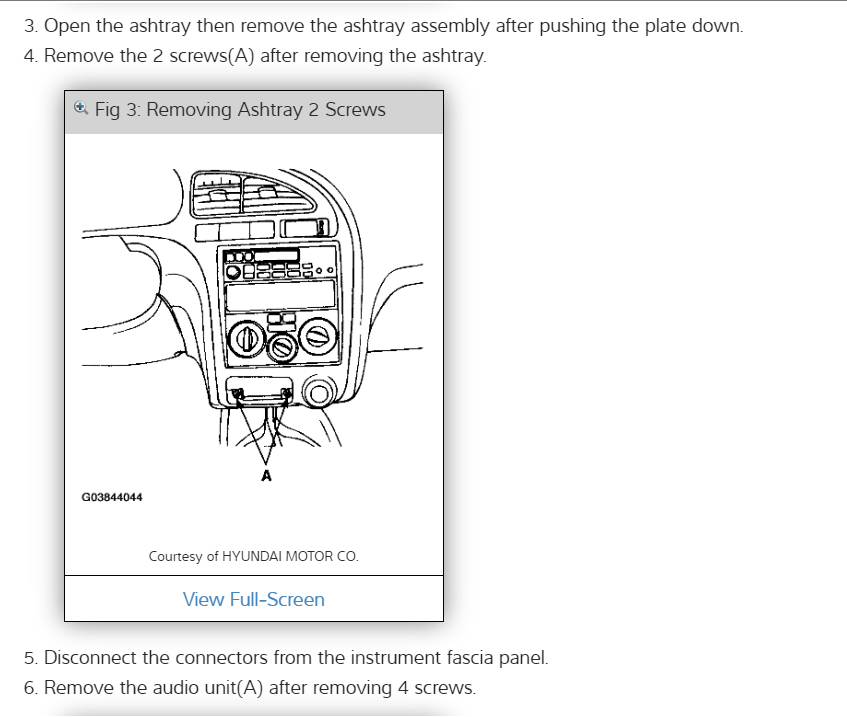

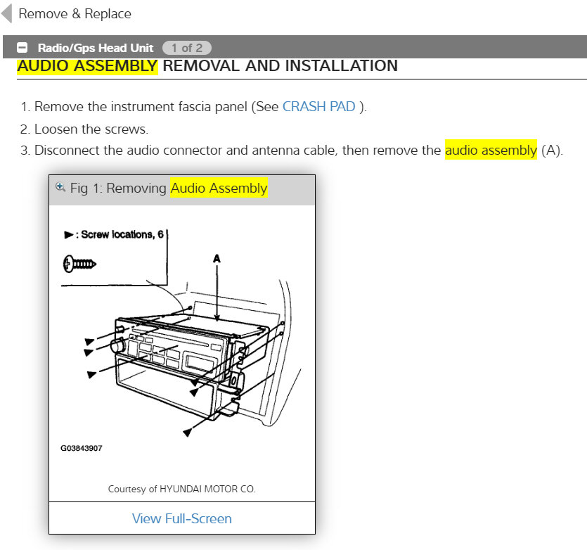

Here are the instructions on how to remove and replace the radio. Check out the images (below). Please let us know if you need anything else to get the problem fixed.
