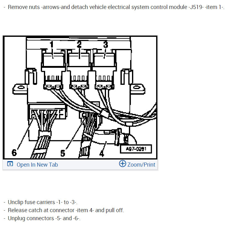

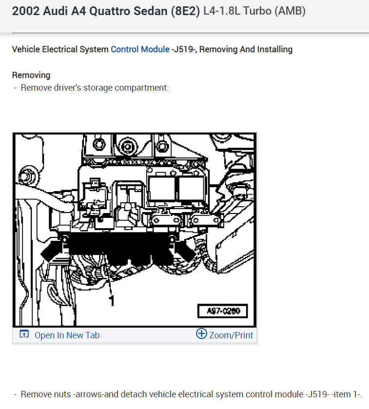

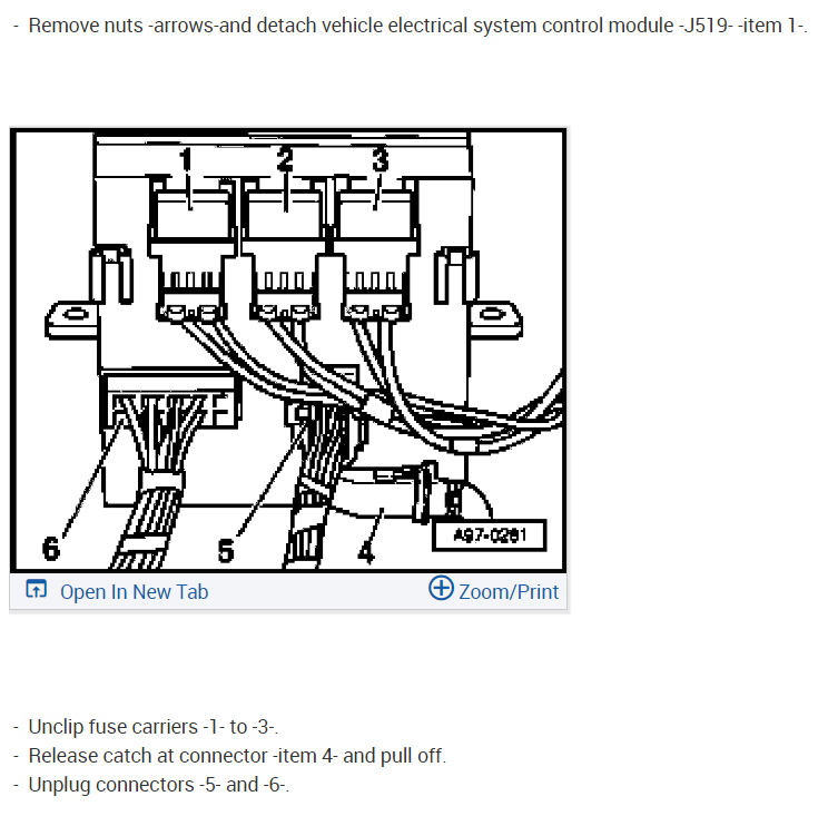

Yes, this happens when the "vehicle electrical system control module" goes out here is the location so you can change it out which should fix the problem. Check out the images (below). Let us know if you need anything else.
