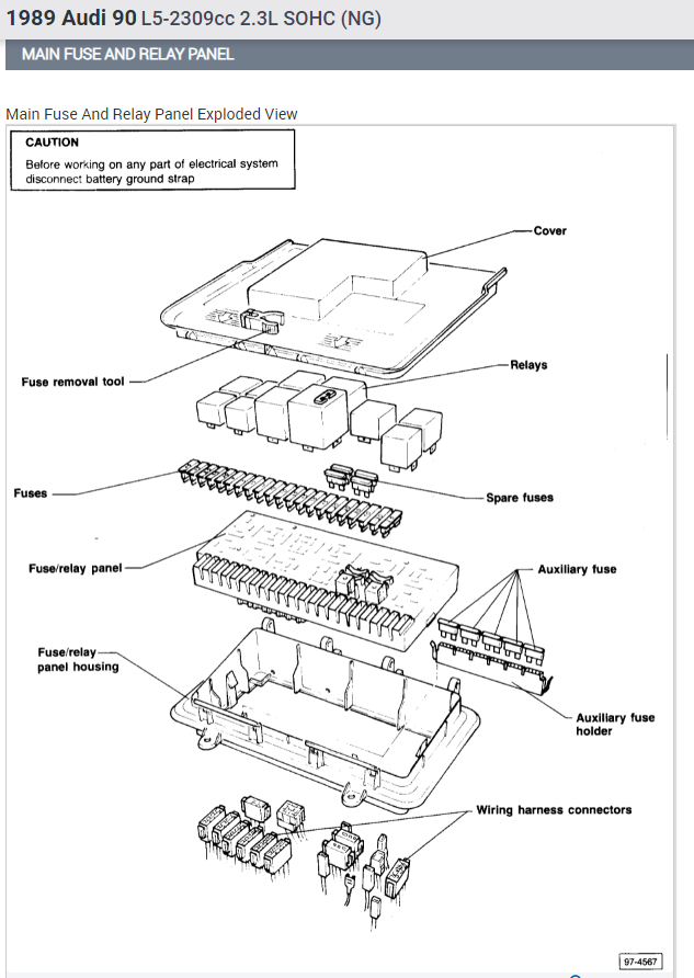

The diagnostics port can be either of two locations, depending on the manufacturers date for this vehicle.
I can be under the hood, in the fuse box that is close to the firewall.

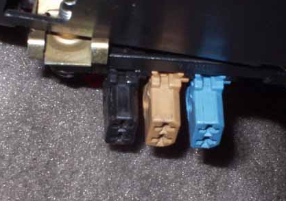

Or it can be under the dash next to where the steering shaft goes into the firewall.
Look for 3 connectors next to each other.
