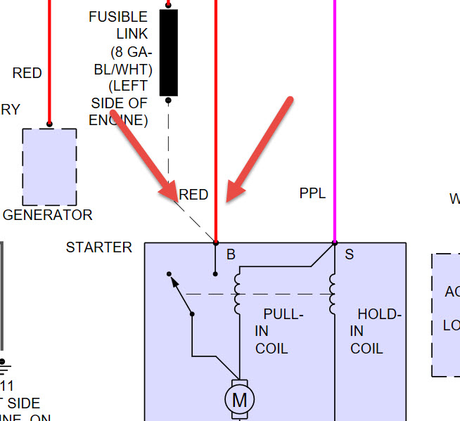

Replacing starter. I have an extra same large gauge wire reluctant attaching to hot wire. any ideas where it goes?

see picture for help. probably you left off fusible link wire.
