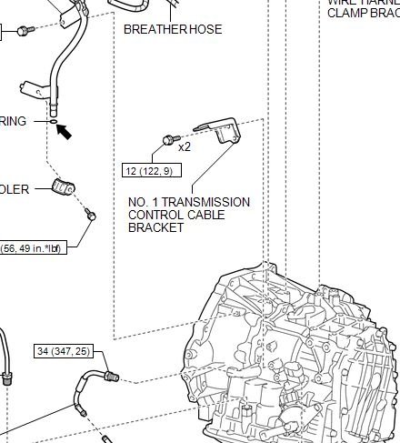

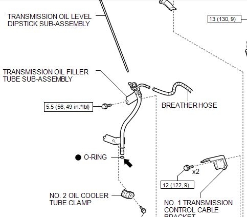

We don't have the exact model in the US, however, I believe it is the same as the Yaris. With that in mind, here is what I can offer. First, if there is a reservoir, there should be full mark indicator on it. That can be used in place of a dipstick. Also, I attached a picture of what we have on the Toyota Yaris. I had to break the picture in two parts because of its size. If you first locate the dipstick and tube (where the bolt attaches it to the transmission) and follow the dotted line down to the second picture, you will see where it mounts on the side of the transmission.

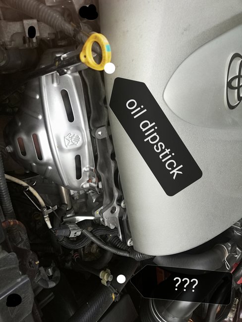

Hello sir, thank you for the reply. this is my under hood. only oil dipstick present in the hood. where is for the ATF? thank you sir

If there is one for the transmission, and there may not be, it will be to the right of the engine oil check and mounted on the transmission.
Keep in mind, since there is a reservoir, there may not be a check. On vehicles without a reservoir or dipstick, the fluid is checked while the vehicle is running and from a fill point on the transmission. In such designs, the fluid is to be at the fill port level under specific conditions. For example, the transmission at a specific temp, engine running.
I'm sorry I don't have the specifics on your vehicle.
